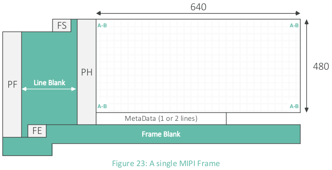

We are working with a sensor that outputs a RAW12 (0x2C) image plus Embedded Data (MetaData) (0x12) as shown in the image. We are getting completely correct images from the RAW12 data and now we are trying to get the meta data out in the same data buffer without success. In the reference manual there are a few mentions of the Embedded Data type, but nothing concrete on how to get it out alongside a different data type. Also the meta data is of a different size than that of the normal image. For our application this meta data is important.
Does iMX8M CSI support metadata/embedded data? And can it output it in the same data buffer as the rest of the normal image, or is there a different way to get it out?

Just the metadata. IMX8 only takes one datatype unless fast switching of datatype after captured a metadata.

Now I'm checking it and it turns out that it captures the first line of image data. It's not capturing the metadata line.
NXP need to answer it. Does NXP verify IMX8 CSI capturing DT (0x12)?

I can extract one line of metadata.
#define BIT_MIPI_DATA_FORMAT_META (0x12 << 25)
if (pix->height == 1) {
cr18 |= BIT_MIPI_DATA_FORMAT_META;
csi_dev->csi_two_8bit_sensor_mode = false;
csi_write(csi_dev, cr18, CSI_CSICR18);
valid_res[] = {
[4] = {1920, 1080},
[5] = {1920, 1},      // metadata

CSI will not receive mixed signal (RAW + metadata) and be able to discriminate and handle the RAW data. In order to receive this kind of data, you'll have to set CSI to receive generic data and store it on memory., like you already try it.
