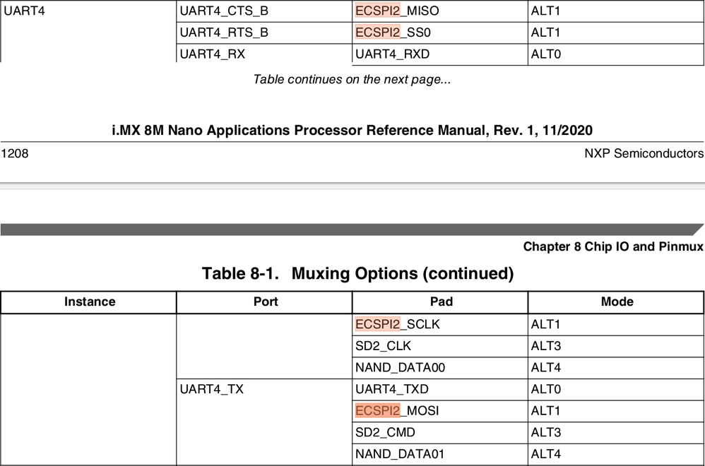

Sanket_Parekh
Hi @moose
We can use UART4 pads as a ECSPI2. And the same UART4 is enabled and used in M7. This might be the reason why SPI line is not working. Please find the reference from below.
One can disable all the peripherals which are enable in M7 core and check the status of ECSPI2.
Thanks & Regards
Sanket Parekh
