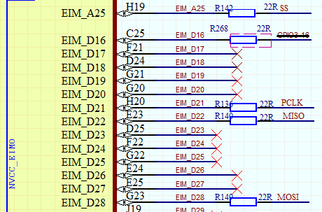

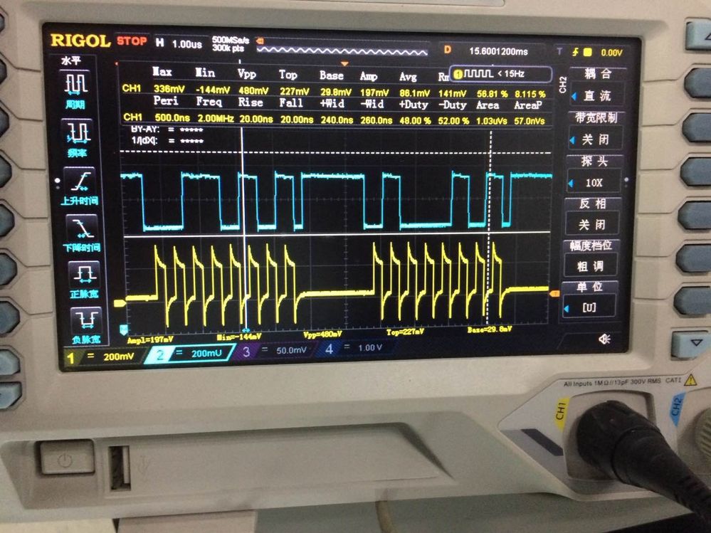

      I have a problem in spi driver ,platform is imx6D6AVT&&linux3.0.35,I can't get rx Interrupt when using  spi4 as salve mode,the hardware connection is EIM_A25,EIM_D21,EIM_D22,,EIM_D28,so i mustchose SS1 as chip select?  ECSPI4_CONREG:0x00f0e101;   ECSPI4_CONFIGREG:0x00f00000; ECSPIx_INTREG=0xf8,is this config avalible?
   I can only get TXFIFO Empty Interrupt,when ECSPIx_INTREG=0xff,so I write 0x1 to ECSPI4_TXDATA  to stop it,if TXDATA buffer is not NULL,how can i start read bytes from master,by setting ECSPIx_CONREG xch bit with 1?
      thank you!!!

Hi lei
one can check ERR009535 eCSPI: Burst completion by SS signal in slave mode is not functional
i.MX6DQ Errata
https://www.nxp.com/docs/en/errata/IMX6DQCE.pdf
mainline slave support
[PATCH RFC 5/5] spi: imx: Add support for SPI Slave mode for imx53 and imx6 chips

thank you,so i can only use mosi miso pclk,is that right?
