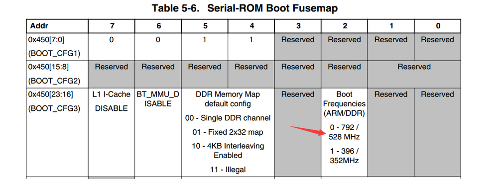

But the boot fusemap we use is 0-792/528MHz, do it cause the problem?
4,630 Views
igorpadykov
yes it can cause problem.
