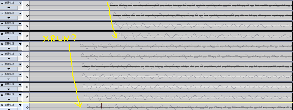

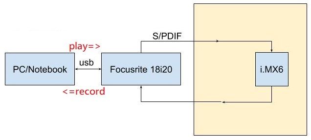

We use i.MX6 for audio processing, do ASRC to fixed S/PDIF input in 48kHz.
Without any process, i.MX6 direct pass 48kHz S/PDIF to output.

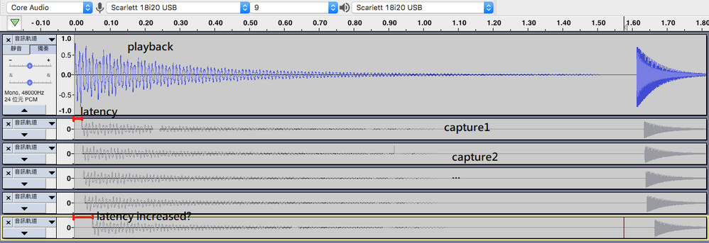

The latency between playback(to i.MX6) and recording(from i.MX6) will increase.

    • the argument [-t] won't change result
  • Latency between PC and Focusrite is 5ms and it is very stable
    • PC => Focusrite spdif out => Focusrite spdif in => PC

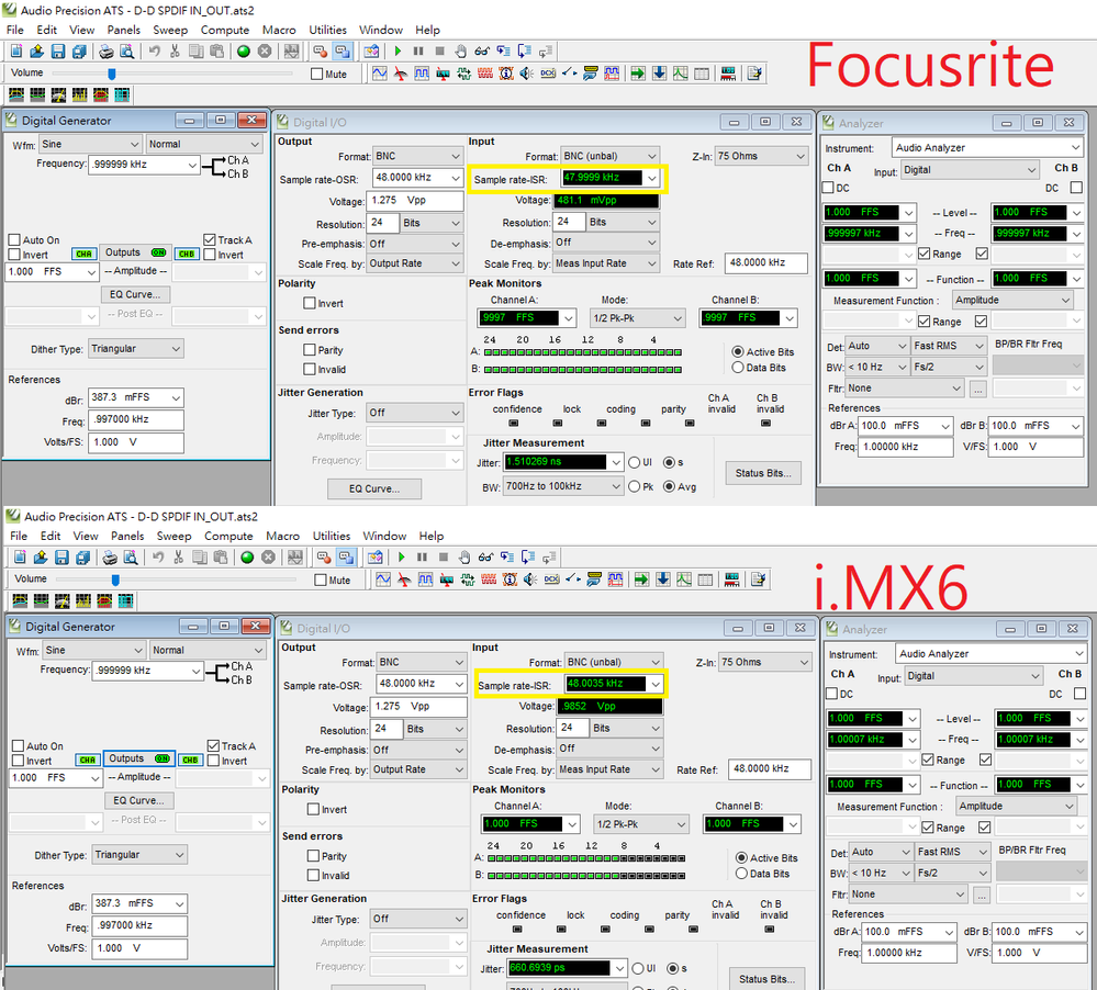

    • expected clock rate = 227328000
    • actual clock rate = 227368421
    • set sample rate to 48008Hz for 48000Hz playback

  • Audio Precision, measure spdif out for Focusrite and i.MX6
    • Focusrite sample rate 47999.9 Hz (diff < 0.1)
    • i.MX6 sample rate 48003.5 Hz (diff > 3.5)
  • Latency increase until XRUN occur

  1. Why does the latency increase ( until underrun occurs ) ?

About the latency, my concern is not "how low" but "how stable".
We believe that something may happen causing an increase in latency, e.g., choose a wrong clock source.
First we have a stable experimental environment, then we discuss and debug how to reduce latency.
