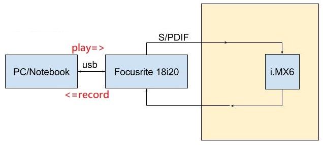

We use i.MX6 for audio processing, do ASRC to fixed S/PDIF input in 48kHz.
Without any process, i.MX6 direct pass 48kHz S/PDIF to output.
The latency between playback(to i.MX6) and recording(from i.MX6) will increase.
Environment
  • PC software
    • [Audacity]
    • play and record
  • i.MX6
    • $ alsaloop -P sysdefault:CARD=imxspdif -C sysdefault:CARD=imxspdif -r 48000 -t 8192 -vvvv -f S16_LE
    • the argument [-t] won't change result
  • Latency between PC and Focusrite is 5ms and it is very stable
    • PC => Focusrite spdif out => Focusrite spdif in => PC
Logs and observation
  • alsaloop log, please refer to the attachment
    • expected clock rate = 227328000
    • actual clock rate = 227368421
    • set sample rate to 48008Hz for 48000Hz playback
    • many underruns for playback
    • many times do resync
  • Audio Precision, measure spdif out for Focusrite and i.MX6
    • Focusrite sample rate 47999.9 Hz (diff < 0.1)
    • i.MX6 sample rate 48003.5 Hz (diff > 3.5)
  • Latency increase until XRUN occur

Question
  1. Why does the latency increase ( until underrun occurs ) ?
  2. Why actual CPU clock differ than expected clock ?
  3. How to bypass i.MX6, directly pass spdif-IN to spdif-OUT ?

Hi William
nxp linux does not provide any specific or guaranteed latencies, so
one can try to analyze latencies using description of spdif driver in
sect.7.4 The Sony/Philips Digital Interface (S/PDIF) attached Linux Manual
and AN4553 Using Open Source Debugging Tools for Linux on i.MX Processors
https://www.nxp.com/docs/en/application-note/AN4553.pdf
Also may be recommended to try extended support with Professional Services
NXP Professional Services | NXP
igor

Hi igor,
Thank you for your prompt reply.
About the latency, my concern is not "how low" but "how stable".
We believe that something may happen causing an increase in latency, e.g., choose a wrong clock source.
First we have a stable experimental environment, then we discuss and debug how to reduce latency.
We know i.MX processor will do ASRC or something processing between receive spdif and transmit spdif, so we would like to know how to bypass all processing, e.g., modify SPDIF_SCR, SPDIF_SRPC, etc.
