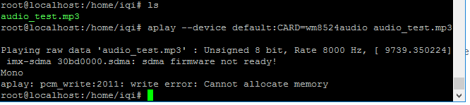

Hi all:
kernel:4.14.78
machine:imx8mqevk
distro:fsl-imx-xwayland
rootfs:ubuntu 18.04

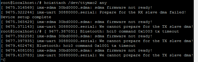

In the process of uboot loading the kernel,dmesg log follow:
Causing Bluetooth and Audio Card not to work properly,
please tell me that how to solve it,thanks!!!

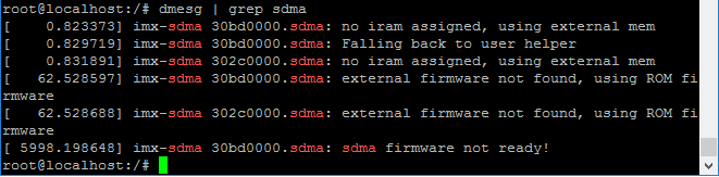

b36401
Please try to add IMAGE_INSTALL_append = " firmware-imx firmware-imx-sdma " into local.conf.

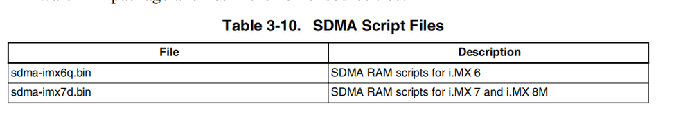

b36401
Please make sure that you have right SDMA driver.

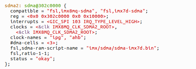

gaobo
in dts,success config

linux_downey
Hi gao bo:
   Have you solved this problem?
   I got the same error when I used the serial port .
@Victor Linnik
   Is there any solution? I  have checked the firmware as the same above.
Thanks.
