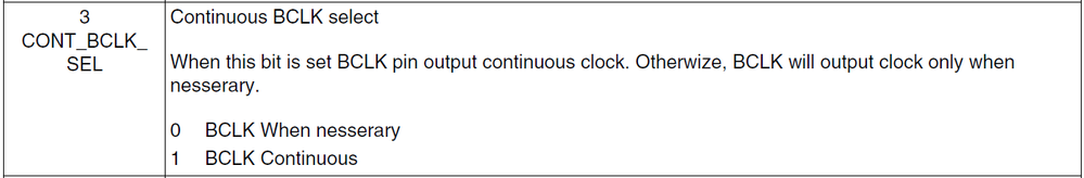

    I am designing a product using the iMX6ULL. I need a clock to run my FPGA and cannot use
CCM Clock 1 or 2 since I am using SD card port 1 and I need the JTAG port operable. I am
thinking of using EIM "BCLK" and have found the "CONT_BCLK_SEL" bit in the EIM_WCR register.
There seems to be a lot of discussion in the community whether BCLK can function like one of the
CCM_CLK, this is possible? Will it work for my MCIMX6Y2CVM08AB part? I would like to test this
signal on my Freescale iMX6ULL-EVK and would also like to know how to change the UBOOT/ LINUX
software to accomplish this function from startup? If "BCLK"  is not continuously possible can you suggest
any other means of getting a continuous clock for the iMX6ULL part?
Thanks for reading and helping!
Larry

(1) About EIM_BLCK
yes, the clock can be configured as continous in register EIM_WCR
more detailed information ,see reference manual, please!

(3) Signal transmission synchronous clock
If your FPGA is connected to EIM interface and use SYNC mode, it is no problem to use BLCK for FPGA.  It is not recommended that you use BCLK as the working clock of FPGA.
