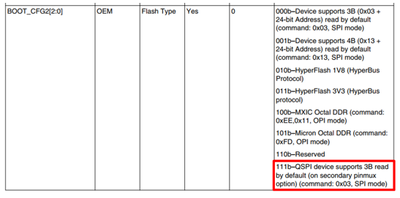

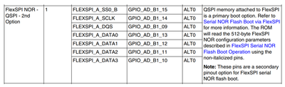

We are using MCU PN MIMXRT1051CVL5B.
The Boot will be through an external 8Mb serial NOR Flash using the NXP 3.3V FlexSPI port A secondary pins (see pictures below).
We want the user to do SW updates (write new data to the external flash) through the host without additional HW steps to support the SW updates.
Can we program the external flash through the host when the boot mode is defined as "boot from fuse"?
