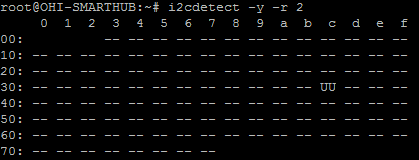

I used i2cdetect to check whether the OV5640 got initialized on the I2C3 bus. It detects a device at address 0x3C as shown below.
pastedImage_4.png.
I still get error message in the boot-log as
Does this mean that the camera chip is getting detected but not responding? What could be the possible reason?
Varma

Hello,Varma,
     I2C3 on MX53QSB is pulled up to 3.3V High, I remember VDDIO of OV5640 should be 1.8V or 2.8V, if it's VDDIO=1.8v, CPU I2C3 can't communicate with ov5640 module. If it's VDDIO=2..8v, i2c2 should normally transmit data between CPU and OV5640 even if you don't use I2C level shifter.
     So please check VDDIO's voltage of OV5640 module.
