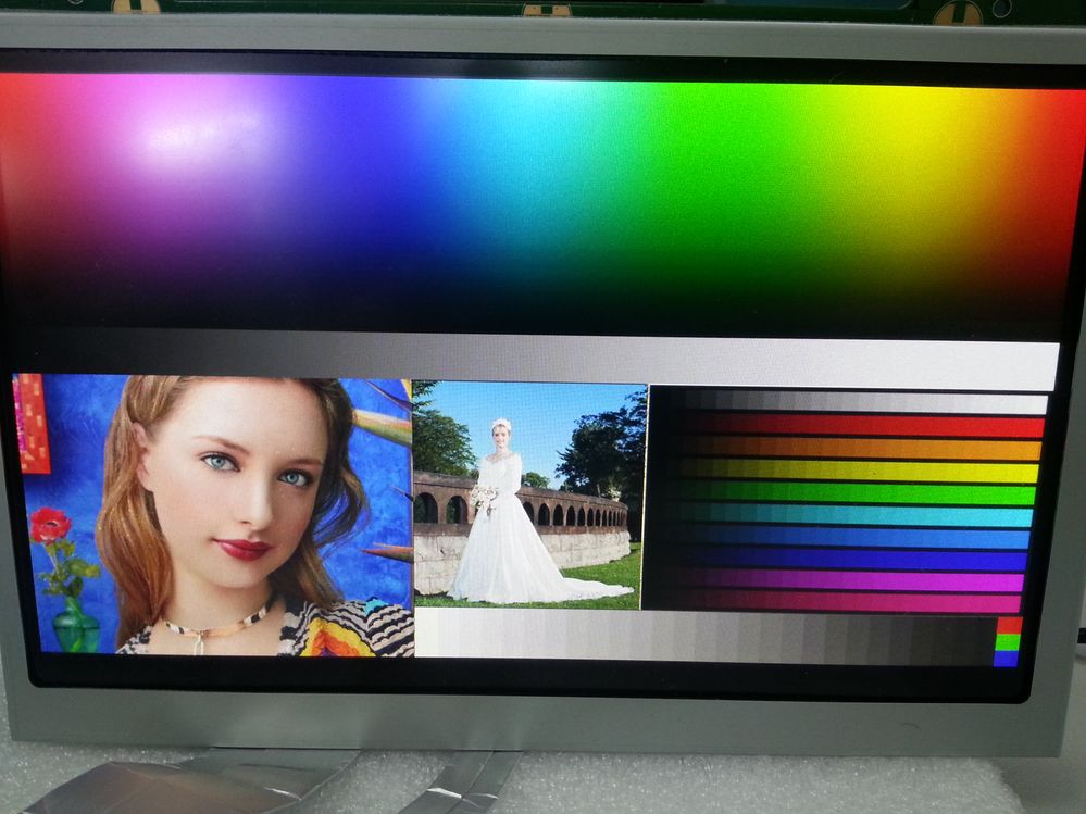

I’m porting 3.10.53 kernel to imx6qsabre based custom board, the board use rgb24 interface lcd panel,
pinctrl control config correct (u-boot logo display ok, kernel log display ok), rootfs build with yocto-layers,
but when i run a opengles 2.0 test program. it display as below,  someone can give me any ideas ?
regards.

Probably you need to check the uboot parameters and resolution for RGB24, also you should try the unit test for the IPU, or the OBDS.

I think my resolution settings is not wrong,  operating on mxcfb is ok,  just opengles has problem. below is the mxcfb testing result photo. and my display pinctrl settings follow it .
my uboot pinctrl settings
#define DISPLAY_RGB_PAD_CTRL  MUX_PAD_CTRL(NO_PAD_CTRL)
iomux_v3_cfg_t display_rgb_pads[] = {
    MX6_PAD_DI0_DISP_CLK__IPU1_DI0_DISP_CLK | DISPLAY_RGB_PAD_CTRL,
    MX6_PAD_DI0_PIN15__IPU1_DI0_PIN15 | DISPLAY_RGB_PAD_CTRL,
    MX6_PAD_DI0_PIN2__IPU1_DI0_PIN02 | DISPLAY_RGB_PAD_CTRL,
    MX6_PAD_DI0_PIN3__IPU1_DI0_PIN03 | DISPLAY_RGB_PAD_CTRL,
    MX6_PAD_DI0_PIN4__GPIO4_IO20 | DISPLAY_RGB_PAD_CTRL,
    MX6_PAD_DISP0_DAT0__IPU1_DISP0_DATA00 | DISPLAY_RGB_PAD_CTRL,
    MX6_PAD_DISP0_DAT1__IPU1_DISP0_DATA01 | DISPLAY_RGB_PAD_CTRL,
    MX6_PAD_DISP0_DAT2__IPU1_DISP0_DATA02 | DISPLAY_RGB_PAD_CTRL,
    MX6_PAD_DISP0_DAT3__IPU1_DISP0_DATA03 | DISPLAY_RGB_PAD_CTRL,
    MX6_PAD_DISP0_DAT4__IPU1_DISP0_DATA04 | DISPLAY_RGB_PAD_CTRL,
    MX6_PAD_DISP0_DAT5__IPU1_DISP0_DATA05 | DISPLAY_RGB_PAD_CTRL,
    MX6_PAD_DISP0_DAT6__IPU1_DISP0_DATA06 | DISPLAY_RGB_PAD_CTRL,
    MX6_PAD_DISP0_DAT7__IPU1_DISP0_DATA07 | DISPLAY_RGB_PAD_CTRL,
    MX6_PAD_DISP0_DAT8__IPU1_DISP0_DATA08 | DISPLAY_RGB_PAD_CTRL,
    MX6_PAD_DISP0_DAT9__IPU1_DISP0_DATA09 | DISPLAY_RGB_PAD_CTRL,
    MX6_PAD_DISP0_DAT10__IPU1_DISP0_DATA10 | DISPLAY_RGB_PAD_CTRL,
    MX6_PAD_DISP0_DAT11__IPU1_DISP0_DATA11 | DISPLAY_RGB_PAD_CTRL,
    MX6_PAD_DISP0_DAT12__IPU1_DISP0_DATA12 | DISPLAY_RGB_PAD_CTRL,
    MX6_PAD_DISP0_DAT13__IPU1_DISP0_DATA13 | DISPLAY_RGB_PAD_CTRL,
    MX6_PAD_DISP0_DAT14__IPU1_DISP0_DATA14 | DISPLAY_RGB_PAD_CTRL,
    MX6_PAD_DISP0_DAT15__IPU1_DISP0_DATA15 | DISPLAY_RGB_PAD_CTRL,
    MX6_PAD_DISP0_DAT16__IPU1_DISP0_DATA16 | DISPLAY_RGB_PAD_CTRL,
    MX6_PAD_DISP0_DAT17__IPU1_DISP0_DATA17 | DISPLAY_RGB_PAD_CTRL,
    MX6_PAD_DISP0_DAT18__IPU1_DISP0_DATA18 | DISPLAY_RGB_PAD_CTRL,
    MX6_PAD_DISP0_DAT19__IPU1_DISP0_DATA19 | DISPLAY_RGB_PAD_CTRL,
    MX6_PAD_DISP0_DAT20__IPU1_DISP0_DATA20 | DISPLAY_RGB_PAD_CTRL,
    MX6_PAD_DISP0_DAT21__IPU1_DISP0_DATA21 | DISPLAY_RGB_PAD_CTRL,
    MX6_PAD_DISP0_DAT22__IPU1_DISP0_DATA22 | DISPLAY_RGB_PAD_CTRL,
    MX6_PAD_DISP0_DAT23__IPU1_DISP0_DATA23 | DISPLAY_RGB_PAD_CTRL
display parameters:
static struct display_info_t const displays[] = {{
    .bus    = -1,
    .addr    = 0,
    .pixfmt    = IPU_PIX_FMT_RGB24,
    .detect    = NULL,
    .enable    = NULL,
    .mode    = {
        .name           = "AA-WVGA",
        .refresh        = 60,
        .xres           = 1280,
        .yres           = 720,
        .pixclock       = 14492,
        .left_margin    = 107,
        .right_margin   = 91,
        .upper_margin   = 37,
        .lower_margin   = 11,
        .hsync_len      = 2,
        .vsync_len      = 5,
        .sync           = FB_SYNC_HOR_HIGH_ACT | FB_SYNC_VERT_HIGH_ACT,
        .vmode          = FB_VMODE_NONINTERLACED
And where can i get ipu test units.

      bootarg fbpix=BGR32

It's still not working, either I change ipu input pixel format in _setup_disp_channel1 to  IPU_PIX_FMT_BGR32.
I think there is problem when gpu translate data to ipu, but I can not find where it is .
