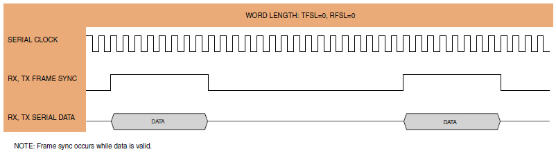

I have a question about Frame sync setting of ESAI of i.MX6DL.
I want to use One bit length frame sync mode such as the following figure.
I set TFSL=1 and RFSL=1.
However, I was not able to get the intended waveform.
Furthermore, is there the register whom I should set?
By the way, in setting of TFSL=0 and RFSL=0, I was able to get the intended waveform.

Hi Yuuki
described picture is for normal mode, so please verify
that normal mode used in the case.
