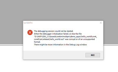

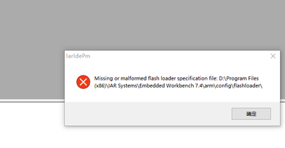

hi:
when I use IAR to develop the M4 in IMX8,I can not load project into m4 by j-link.then it will show some file is missing.like that
2,052 Views

春华张
thanks for your reply.
I use MIMX8QM ,J-FLASH V6.86f,IAR 7.60.2.
I had get "iar_support_patch_imx8qm".
when I use IAR to debug ,it will say missing some file as these pictures show.
and when I use j-flash to connect the iMX8 ,it will say :
- ERROR: Could not perform target reset
- ERROR: Failed to connect.
Could not perform custom init sequence.
