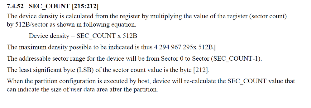

What is the maximum emmc supported by i.mx8 : MIMX8ML8CVNKZAB?

pengyong_zhang
Hi @ZZ383
The iMX8MP supports eMMC Flash 5.1, which means all of the eMMCs of this generation (5.1) are supported.
What is your requirement for the capacity of EMMC?
B.R
2,047 Views
ZZ383
Hi @pengyong_zhang
Our requirement is 4Tb.
Could you please check and let us know if i.mx8plus supports this in emmc5.1. will there be any addressing limitation with this max storage capacity.
1,977 Views
pengyong_zhang
Hi @ZZ383
As i said before, As long as your EMMC follow the EMMC 5.1 Spec, It can works fine. But But we have only verified 32GB EMMC. So you need to check your EMMC datasheet by yourself.

gidame
JEDEC Standard No. 84-B51
