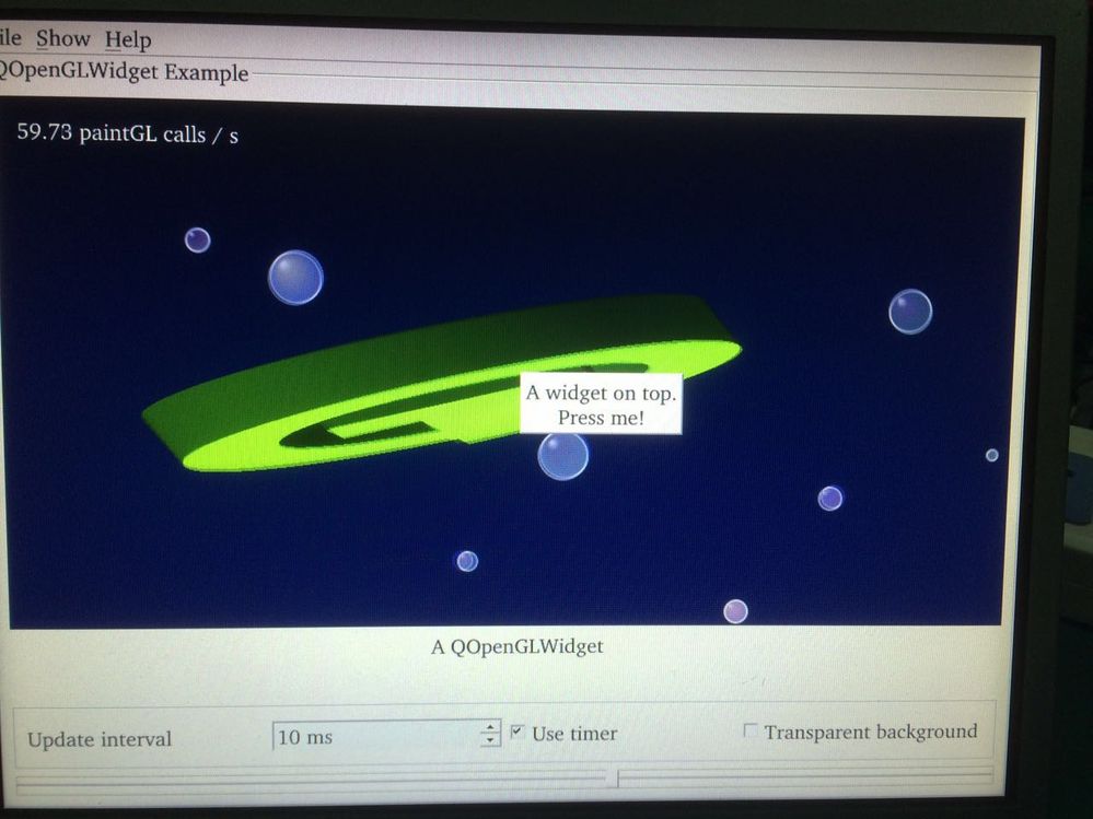

Hi everyone:
     When I want to develop application with Qt5.4.2,I download the sourcecode named qt-everywhere-opensource-src-5.4.2.tar.gz from Qt-Download,and buid it according toAdeneo Embedded: Building Qt 5.1 for Freescale i.MX6 – A white paper by Cuong Chou ,copy the generated directory to rootfs/usr/local/Trolltech,using nfs & tftp to boot through localnet,when I use the example hellogl2,there are soma issues Which not appeared when I use Qt5.3.2.
Now the issues are:
root@freescale /$ ./hellogl2
Unable to query physical screen size, defaulting to 100 dpi.
To override, set QT_QPA_EGLFS_PHYSICAL_WIDTH and QT_QPA_EGLFS_PHYSICAL_HEIGHT (in millimeters).
Cannot find libdbus-1 in your system to resolve symbol 'dbus_get_local_machine_id'.
Aborted
     Well,I try to  set QT_QPA_EGLFS_PHYSICAL_WIDTH and QT_QPA_EGLFS_PHYSICAL_HEIGHT in /etc/profile such as
export QT_QPA_EGLFS_PHYSICAL_WIDTH=100
export QT_QPA_EGLFS_PHYSICAL_HEIGHT=80
as a result,issue 1 not appears,but issue 2 remains,such as:
root@freescale /opt$ ./hellogl2
Aborted
I have no idea how to solve it,Thanks for your help!

I resolved the two issues through:
1.vi /etc/profile(on board)
export QT_QPA_EGLFS_PHYSICAL_WIDTH=210
export QT_QPA_EGLFS_PHYSICAL_HEIGHT=158
(I measured the screen by a plastic ruler-_-!!!Later I found it`s no need....Orz....)
also no use to set,it will use default.
2.
cd qt-everywhere-opensource-src-5.4.2/qtbase/src/dbus
make
make install
cp -rf <generated directory> <on board directory>
3.boot board
./qopenglwidget
