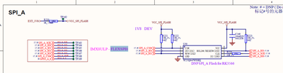

weiber1991
I did it this way.
Our board has some differences from the EVK. Could you help check if the configuration is correct?
my configuration

schematic
874 次查看
Zhiming_Liu
SDK setting is for 8pad flash, but you have 4 pad, need to delete other pads in pinmux.
nor_flash_adesto.c, cm33/nor_flash_common.c, cm33/nor_flash_gigadevice.c and cm33/nor_flash_macronix.c are for different flash device. You need to add similiar here for your flash. Need to add your flash code in flexspi_nor_enable_octal_mode and flexspi_nor_flash_init etc...
