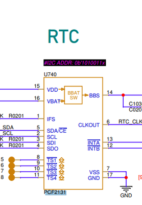

In the imx93 datasheet I can see that there is a internal RTC within the BBSM part. It seems that this rtc is controlled by the ele:
Battery Backed Security Module (BBSM)
• Secure real-time clock (RTC)
Is there any way to use it with Linux thru the ELE API or other? ideally, is there a kernel driver on track?

Thanks for your answer. Is it something likely to be implemented in a near future? It is BOM-cost friendly...

It seems that Linux can not control the RTC BBSM directly, and also, the ELE API just have the Enable RTC command:
So, it is recommended to use an external RTC as you can see on EVK or i.MX93 FRDM board:
It is using the PCF2131, and there is a driver in our BSP.
Unfortunately there is not a Linux driver for the RTC on  BBSM of i.MX93.
