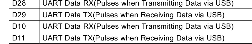

nahakprabhakar
Thanks for the feedback. nxf46838
I've checked the correct port for A35 core which is /dev/ttyUSB0 in case of linux system and COM3 in Windows. I could also confirm that data is being transmitted by confirming D28 and D29 LED is blinking.
For M4 core it is /dev/ttyUSB1 and COM4, I've confirmed the same by checking D10 and D11 is blinking. In this even console logs are coming.
I've also tried updating FT2232D driver and even after that the same state. i.e., For COM4 (M4-Core) logs are coming but not for COM3 (A35-Core).
Attached is the Quick User Guide of imx8qxpevk board for LED lights.
Let me know if you've any other suggestion to recover the same. If it still doesn't work, probably the UART port has gone bad.

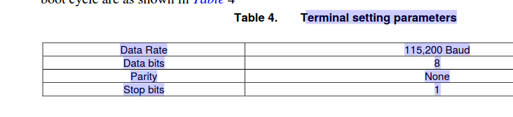

On further investigation, I found that terminal for M4 core is working fine, however for A35 core nothing is coming. No uboot logs or anything. Do you think the debug port itself is damaged? Or there are ways to activate the corresponding UART terminal.
According to the user manual.
The smaller number is for Arm® Cortex®-A35 core and the bigger number is for Arm® Cortex®-M4 core.
2.10.UART connector (J11)The i.MX8QuadXPlusMEKRev.C Board has twoindependent UART Ports (UART0, M40_UART0)for debugging.A USB to serial UART converter IC (FT2232D) is used in the MEK board for converting the USB signals to UART signals.Make sure the FT2232Ddriver has been installed on your computer for proper operation. If not, you may download it from FTDICHIPwebsite and install: https://www.ftdichip.com/Products/ICs/FT2232D.htmOn the MEKboard, UART0_TX & UART0_RX are used to output serial debugging information for A35-core.M40_UART0_TX & M40_UART0_RX are used to output serial debugging information for M4-core. No RTS or CTS signals are sent from the Processor to the Debug connector asthese signals are ignored by most applications. The required terminal settings to receive debug information during the boot cycle are as shown in
