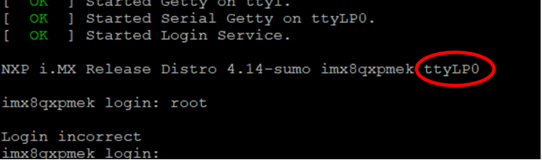

1. Password needed when log in terminal.
2. During the bootup, Var directory in NFS was locked.
Hope you guys give some helpful suggestions.

1. The problem you mentioned caused by the wrong format.
setenv rootfsinfo 'setenv bootargs ${bootargs} root=/dev/nfs ip=dhcp \  nfsroot=${serverip}:/home/cqc/rootfs_4_imx8qxp_4.14.78,v3,tcp'
setenv bootcmd_net 'run rootfsinfo; tftp ${image}; tftp ${fdt_addr} ${fdt_file}; booti ${loadaddr} - ${fdt_addr}'
2. Checked the uboot env difference between i.MX6 and i.MX8, they used different terminals type(see below two pics).
Fig 1. i.MX6 terminal type
Fig 2. i.MX8 terminal type
Checked /etc/securetty file of my server, ttyLP0 is not supported to log in, I think this may the root cause for the log in failure,  can you give some suggestions? Much thanks!

The issue was confirmed as the settings of server(as mentioned before), ttyLP0 is not supported to log in as root, you can replace /etc/securetty file with my attachment, hope it'll helpful!

Actually,
The log-in failure is caused by the authentication of file system, when I set the permission of file system to 777, the failure occurred, so do not change this when you setup the the NFS.

Yes, this is the possible cause of the issue.
