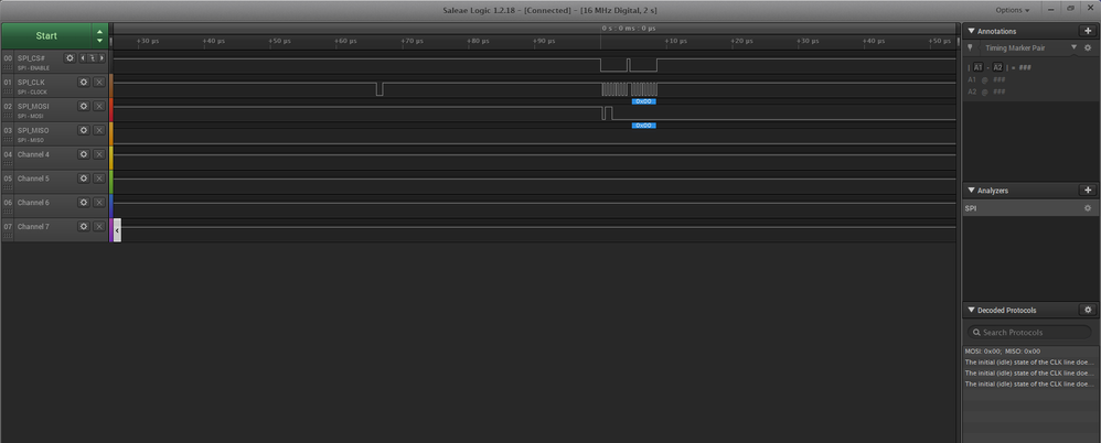

we were trying to connect KSZ8795 switch via MDIO to imx8qx, but it was wrong, because not all features are supported via SPI. Now we are trying to connect it via SPI, but there is still something amiss. At first we same problems as in KSZ8795-SPI-setup and changed from native chip select to gpio and at least some communication happens with switch.
Kernel is built with following options, .ko files are built and can be loaded with insmod

There are two problems.

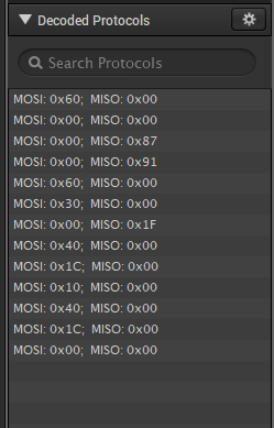

1. When ksz8795_spi is loaded for the first time it fails with "ksz8795-switch: probe of spi1.0 failed with error -22" .We've checked communication and think that i.MX for some reason toggles spi_clk shortly before communication which causes following communication to fail. Only the first attempt fails. Every next attempt doesn't have this toggle and some data is received in all following attempts. Do you have any idea what could be causing this toggle on spi_clk?
1st spi communication fail1st spi communication fail
2. After that we rmmod and insmod spi driver again and spi communication looks better this time, e.g. first 4 data transfers are read register 0, and response is 0x8791 which is correct for KSZ8795. However after one more read and 2 write operations nothing else happens, no output in dmesg and "Unable cannot connect to phy" if attempting to up the interface.

spi dataspi data

2. Another problem were spi-cpha and spi-cpol options in ksz device tree node, we have copied them from some examples, but they are not necessary and were causing strange effects on spi communication and should be removed.

Hi sergey_tarassen
1. for "toggle spi_clk" issue one can try to use latest Linux 5.4.47_2.2.0​​ from
source.codeaurora.org/external/imx/linux-imx repository

sergey_tarassen
1. Unfortunately there is still the same short drop in SPI CLK, with the new 5.4.47_2.2.0 kernel. Do you have any ideas what else we could check?

igorpadykov
for 1. recommended to reproduce issue on i.MX8QXP MEK board with Demo Images
from    https://www.nxp.com/design/software/embedded-software/i-mx-software/embedded-linux-for-i-mx-applicat...
and lpspi example:
https://source.codeaurora.org/external/imx/linux-imx/tree/arch/arm64/boot/dts/freescale/imx8qxp-lpdd...
