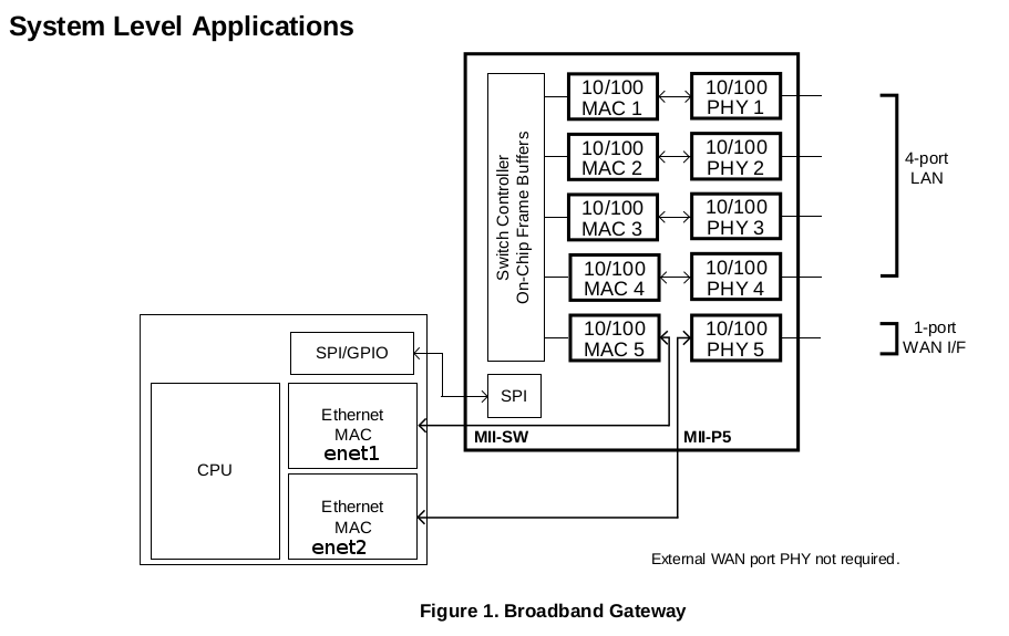

we have custom board based on imx6sx connected with ksz8765 switch over spi bus using rgmii interface. we have enabled the fixed link driver in kernel and also configure same in dts file. Port 5 of the switch is connected to imx6sx MAC interface.
device tree configuration:
&fec1 {
pinctrl-names = "default";
pinctrl-0 = <&pinctrl_enet1>;
phy-mode = "mii";
phy-reset-gpios = <&gpio1 25 GPIO_ACTIVE_LOW>;
fixed-link = <0 1 100 0 0>;
phy-supply = <&reg_vref_3v3>;
status = "okay";

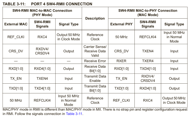

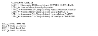

check the sys directory  /sys/bus/mdio_bus/devices/fixed-0\:00 you should see something like this.
you should configure you switch properly to make it work in phy mode either you put strap in hardware options or write switch register using spi bus.9

I use the RMII and spi mode, the manual says
16,588 Views
lvmh
Hi  pavansingpatil,
I use the RMII and spi mode, the manual says:
MAC/PHY mode in RMII is different than MAC/PHY mode in MII. There is no strap pin and register configuration request

Hi  pavansingpatil,
Find this directory with the following information
Can you give me some advice?thanks
