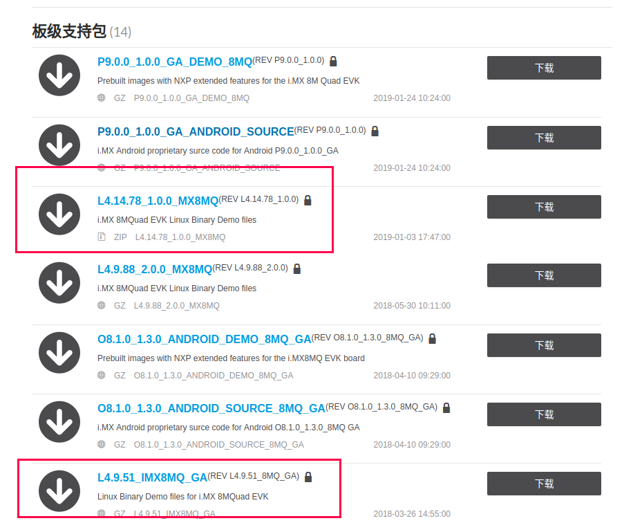

Hi,community:
Our company has customized a motherboard for imx8mq, running yocto system, there are two usb3.0 interfaces on the motherboard, which are connected by two usb3.0hosts on the cpu, respectively connected to two usb3.0 interface cameras. At the same time, two cameras are taken to take the image stream, and the operation is normal at the beginning. After a period of time, the following error is printed:

What is the problem with this?

Hi 传策 薛
RE: XHCI: Ring expansion failure — Linux USB
please try latest Linux L4.14.78
linux-imx - i.MX Linux kernel
Linux L4.14.78_1.0.0 Documentation
i.MX Software | NXP
igor
2,314 Views
传策薛
Contributor V
Is Linux L4.14.78 a GA version?
2,314 Views
igorpadykov
yes it is GA, one can check:
i.MX Software | NXP
igor
