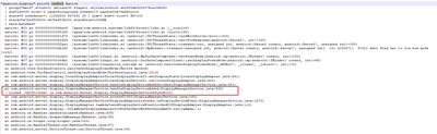

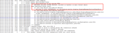

1、 First, according to the log of logcat, it can be concluded that the watchdog closed the system process and was in the main thread
2、 At this time, there will be an anr log. By analyzing the current anr log, it can be concluded that the thread with tid 15 always holds the lock < 0x03514c4d >, resulting in the main thread being unable to obtain the lock
3、 After further analyzing the anr log and checking thread 15, it can be concluded that in the source file displaymanagerservice.java In line 943 , lock is held directly, so that other processes cannot obtain it

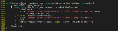

4、 After further tracking the source code, we finally found that it stopped at frameworks/native/services/surfacelinker/surfaceflinger.cpp: 4294, as shown in the figure below, can enter the surfaceflinger::setpowermode function, but cannot enter MAIN_THREAD
5、MAIN_THREAD is an interface to obtain the mstatelock lock. The mstatelock lock is on the surface flinger.cpp source file is called in many places.
