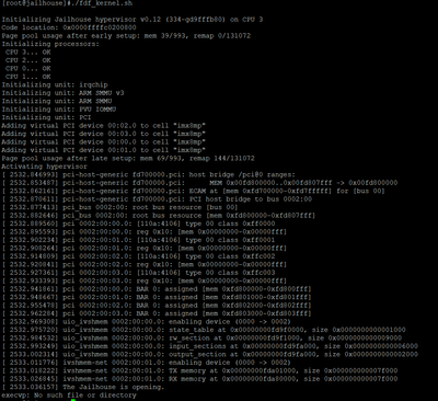

jimmyhua
uboot boot:run jh_mmcboot
after kernel boot, cd /home/root/jailhouse
 insmod jailhouse.ko
./jailhouse enable ./imx8mp.cell
./jailhouse cell linux ./imx8mp-linux-demo.cell /run/media/mmcblk2p1/Image -d /run/media/mmcblk2p1/imx8mp-evk-inmate.dtb -c "clk_ignore_unused console=ttymxc1,115200 earlycon=ec_imx6q,0x30860000,115200 root=/dev/mmcblk2p2 rootwait rw" print execvp: No such file or directory
why?./jailhouse cell linux fail
742 Views
Bio_TICFSL
i.MX jailhouse code could be accessed from https://github.com/nxp-imx/imx-jailhouse
jailhouse only support dual linux, linux plus baremetal. If you would run android, you need customize.
