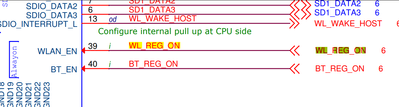

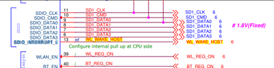

■Question on imx8mm-evk
1. What is the role of MX8MM_IOMUXC_GPIO1_IO00_ANAMIX_REF_CLK_32K?
2. What is the role of MX8MM_IOMUXC_SD1_DATA7_GPIO2_IO9?
3. Which pin on the NXP 88W8987 is MX8MM_IOMUXC_SD1_DATA7_GPIO2_IO9 connected to?
4. Which pin on the NXP 88W8987 is MX8MM_IOMUXC_SD1_RESET_B_GPIO2_IO10 connected to?

1. It configures the pin as alternative CCM_REF_CLK_32K, on our EVK is connected to 2.4G/5G WIFI/BT Module.
2. It configures the pin as alternative GPIO2_IO09 for SDIO_INTERRUPT, on our EVK is connected to 2.4G/5G WIFI/BT Module.
3. Pin W26 and pin 13.
3. Pin R23 and pin 39.
Best regards.
