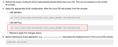

    I run the M7 program on the development board refer to IMX_LINUX_USERS_GUIDE.pdf .
kernel version Linux imx8mpevk 5.15.32-lts
After entering the system, I also copied asound.conf_rpmsg_imx8mp. After restarting, the system cannot find wm8960 audio. tried the 5.10.72 kernel version and couldn't find it either. Is this your bug? What needs to be corrected. thanks

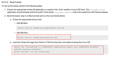

Did you save the environmental variables, when you set both the device tree and the script to fatload the M7 image?
Also, do you see anything in the M7 console?
Aldo.
4,081 Views
aber
Hi AldoG
    found the problem, dts needs to configure imx8mp-evk-rpmsg-lpv.dtb, bin cannot run hello_world, and the sound card can be found under the system. TKS!

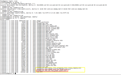

NXP i.MX Release Distro 5.15-kirkstone imx8mpevk ttymxc1
imx8mpevk login: root
root@imx8mpevk:~# aplay -l
**** List of PLAYBACK Hardware Devices ****
card 0: btscoaudio [bt-sco-audio], device 0: 30c20000.sai-bt-sco-pcm-wb bt-sco-pcm-wb-0 [30c20000.sai-bt-sco-pcm-wb bt-sco-pcm-wb-0]
Subdevices: 1/1
Subdevice #0: subdevice #0
card 1: audiohdmi [audio-hdmi], device 0: i.MX HDMI i2s-hifi-0 [i.MX HDMI i2s-hifi-0]
Subdevices: 1/1
card 2: imxaudioxcvr [imx-audio-xcvr], device 0: XCVR PCM snd-soc-dummy-dai-0 [XCVR PCM snd-soc-dummy-dai-0]
Subdevices: 1/1
root@imx8mpevk:~# cat /proc/asound/cards
0 [btscoaudio ]: simple-card - bt-sco-audio
bt-sco-audio
1 [audiohdmi ]: audio-hdmi - audio-hdmi
audio-hdmi
2 [imxaudioxcvr ]: imx-audio-xcvr - imx-audio-xcvr
imx-audio-xcvr
Can't find wm8960 sound card.Do you have any good suggestions?

I'll double check on my side as well, but please note that Cortex-M7 should be running imx8mp_m7_TCM_low_power_voice.bin or imx8mp_m7_TCM_low_power_wakeword.bin not the hello world.
Regarding WM8960 sound card, please note that RPMSG based dts have access to the codec trough I2C rpbus:
https://source.codeaurora.org/external/imx/linux-imx/tree/arch/arm64/boot/dts/freescale/imx8mp-evk-r...
So make sure that you're running the correct Cortex-M7 application.
Aldo.
4,059 Views
aber
Hi AldoG,
    I wonder why running other M7 .bin files why audio can't be found.
4,047 Views
AldoG
This is because when using RPMSG based dts, it will probe the WM8960 sound card trough I2C RPBUS, this will need for Cortex-M7 application to have I2C enabled.
One could check the sai_low_power_audio SDK example for this.
Aldo.
