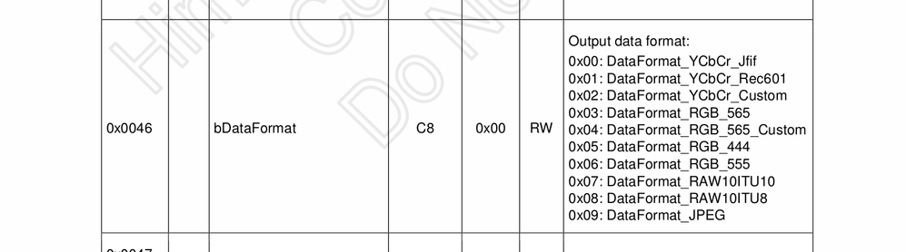

Also, are you sure that your sensor outputs JPEG ? Below is the format option in HM5065 :
K.
I am certain it does not do JPG. It is set to YUYV with the firmware/control commands we send, and also YUYV format is selected in our driver and the CSI driver reports so:
[ 81.803730] video0: VIDIOC_ENUM_FMT: index=0, type=vid-cap, flags=0x0, pixelformat=YUYV, description='YUYV 4:2:2'
Why do you think we selected JPG? In my understanding, gstreamer does this conversion just for convenience (we would be OK with RAW or any format really), because we supply the argument
 ! jpegenc !
with gst-launch. Its just quicker to check a JPG during testing.

Hi @markusnm,
Was you able to capture test.raw with v4l2-ctl command (after launching gst-launch for example)?
Khang

Hi @markusnm ,
I wish I had same HW to do the investigation with you. I saw that you inspired from the ov5640 that had similar characteristics as the HM5065 (resolutions). I would guess that the output format of hm5065 was not recognized by the the SoC.
While the ov5640's default output is YUV422 (reg 0x501F, value 0x00), I would suggest you to enable the test pattern as well as to try with YCbCr_Rec601 (0x01) output instead of YCbCr_Jfif (0x00) in register 0x0046 of hm5065.
K.
