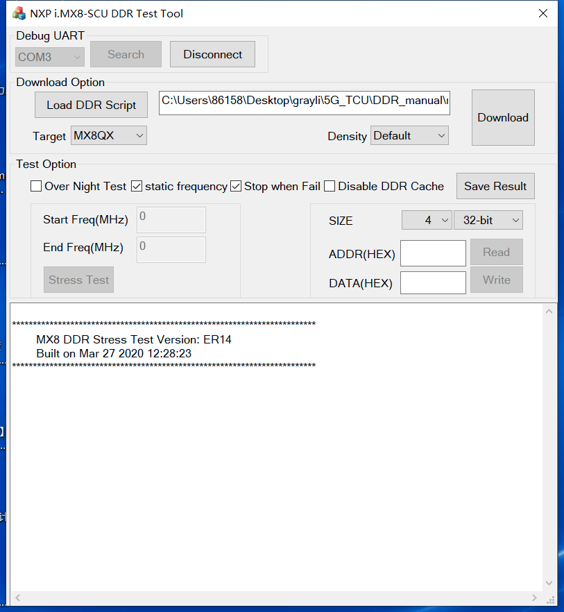

Hello, All
TOOLS:
   MX8QXP_C0_B0_LPDDR4_RPA_1.2GHz_v13.xlsx
   mx8_ddr_stress_test_ER14_installation.zip
BOARD: Imx8qxp mek  DDR stress test
   LPDDR4 3G  --->4G
test log:
MX8 DDR Stress Test Version: ER14
Built on Mar 27 2020 12:28:23
-Set up the MMU and enable I and D cache-
  • This is the Cortex-A35 core
  • Check if I cache is enabled
  • Enabling I cache since it was disabled
  • Push base address of TTB to TTBR0_EL3
  • Config TCR_EL3
  • Config MAIR_EL3
  • Enable MMU
  • Data Cache has been enabled
  • Check system memory register, only for debug
  • VMCR Check:
  • ttbr0_el3: 0x13d000
  • tcr_el3: 0x2051c
  • mair_el3: 0x774400
  • sctlr_el3: 0xc01815
  • id_aa64mmfr0_el1: 0x101122
  • MMU and cache setup complete
ARM Clock(CA35): 1200MHz
DDR Clock: 1200MHz
DDR configuration
DDR type is LPDDR4
Data width: 32, bank num: 8
Row size: 16, col size: 10
Two chip selects are used
Number of DDR controllers used on the SoC: 1
Density per chip select: 2048MB
Density per controller is: 4096MB
Total density detected on the board is: 4096MB
No DDR data training errors detected for DDRC0
MX8QXP: Cortex-A35 is found
DDR Stress Test Iteration 1
-Running DDR test on region 1-
t0.1: data is addr test
t0.2: row hop read test
t1: memcpy SSN armv8_x32 test
t2: byte-wise SSN armv8_x32 test
t3: memcpy pseudo random pattern test
t4: IRAM_to_DDRv1 test
t5: IRAM_to_DDRv2 test
-Running DDR test on region2-
t0.1: data is addr
(Stuck here, didn't know it was wrong, stayed there for 20 minutes, restarted the test many times and still did the same thing)

Hi Wang
one can recheck "BoardDataBusConfig" settings in RPA tool and
tweak drive strength settings.
igor

gravity_one
hello, igor
I don't know why I pressed the download button of the case. Now it is shown in the picture, and there is no other display
tks

gravity_one
hello, igor
can you tell me how to setting "BoardDataBusConfig"?
only modify
Density per channel per chip select (Gb)1:6
to 8.
