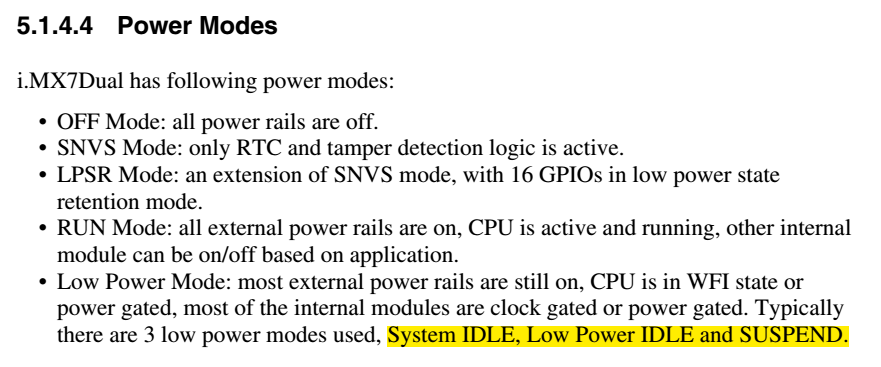

Our Linux Kernel version is 4.1.15 .My question is how to enter 3 kinds of Low Power Mode , LPSR and SNVS in SW method. How can I confirm the cpu is in the mode mentioned above? What's the cpu freqency in different mode and how to measure it? What operating-points does imx7d support in dts file.

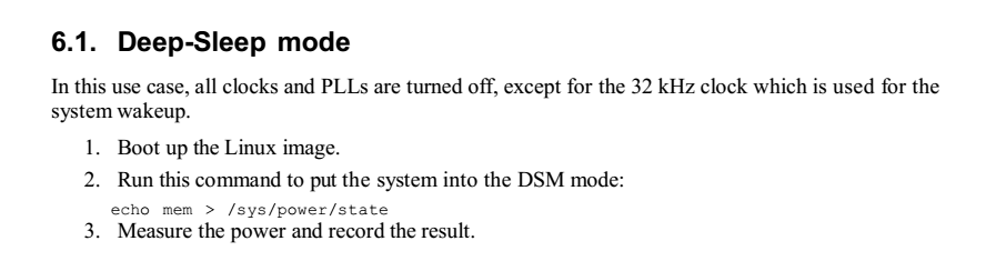

   NXP Linux supports mem (suspend to RAM) mode, that maps to DORMANT mode,
"which offers most significant power saving, as all blocks in the system are put into a low-power state,
except for memory, which is placed in self-refresh mode to retain its contents. If there is
"fsl,enable-lpsr" defined in DTB ocrams node, mem is mapped to LPSR mode instead of DORMANT,
and all the blocks in the system are put into power off state, except the LPSR, SNVS, and DRAM power domains."
 To enter :
$ echo mem > /sys/power/state

willwang
Hi Yuri
So ,"mem" corresponds to "SUSPEND" which is called "Deep-Sleep" in AN5383, is it right?
Thanks for your help.
Will
2,962 Views
Yuri
Yes.

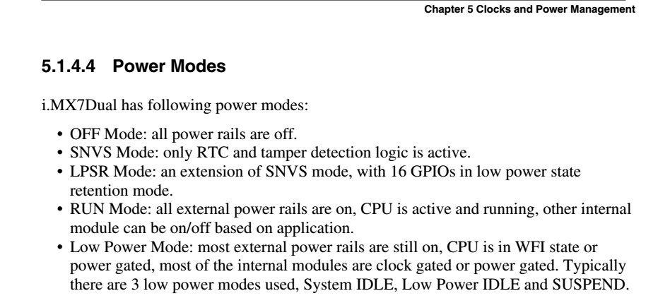

There are three kinds of low power mode in IMX7DRM .They are called "System IDLE","Low Power IDLE" and "SUSPEND".
How to  enter "System IDLE" and "Low Power IDLE"? Which mode will be entered if "echo standby  > /sys/power/state" is executed? What about "echo freeze > /sys/power/state"?

1.
  from i.MX Linux® Reference Manual :
To enter different system level low power modes:
Here standby maps to STOP mode.

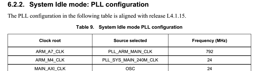

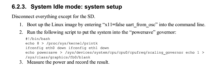

I have read these documents before. I didn't find the way to enter LPSR or SNVS  in SW method. As for System idle , it says " System IDLE - This mode is defined as a mode which CPU can automatically enter when there is no thread running. ",so how to kill all thread ?
I get the way to enter system idle mode in AN5383   6.2. System Idle mode.
it seems that the cpu frequency is 792MHz,but i think the cpufreq should be the lowest frequency of "operating points" which is set in devicetree,and the result of
" cat /sys/devices/system/cpu/*/cpufreq/cpuinfo_cur_freq” is 162MHz.  What's wrong?
I can write “mem”“standby”“freeze” to "/sys/power/state", what's the relationship between these strings and low power modes?
Doesn't executing "cat /sys/devices/system/cpu/cpu0/cpuinfo_cur_freq" stop the idle mode?

Yuri
  >  ... how to kill all thread ...
I do not think this is good idea. Let it will be done automatically.
