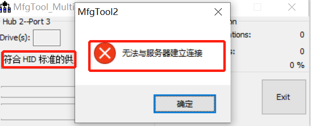

      I'm using imx6ull board and have built a yocto project by setting bitbake fsl-image-machine-test. And I want to use mfgtool to burn files to imx6ull's nand. The cfg.ini is as follows:
       [profiles]
       chip = Linux
       [platform]
       board = SabreSD
       [LIST]
       name = NAND Flash
       And the file's location has no problem. As for the mfgtool.vbs, I also had changed:
Set wshShell = CreateObject("WScript.shell")
wshShell.run "mfgtool2.exe -c ""linux"" -l ""NAND Flash"" -s ""sxuboot=sabreauto""  -s ""sxdtb=sabreauto"" -s ""6ulluboot=14x14evk"" -s ""6ulldtb=14x14-evk"" -s ""board=sabreauto"" -s ""nand=nand"" -s ""nanddtb=gpmi-weim"" -s ""part_uboot=0"" -s ""part_kernel=1"" -s ""part_dtb=2"" -s ""part_rootfs=3""   "
Set wshShell = Nothing
      When I clicked the program's start, it showed:
      How can I deal with it? Hope your help!

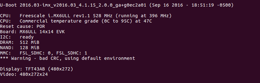

ida_jiang
Hi Rita ,
     I used the L4.1.14_2.0.0_ga's demo for imx6ull and burned the image to nand by uuu & mfgtool. Both of them can't burn successfully. And the log was as follows:
    As for mfgtool, it would get stuck at "jump OS linux".
    Have you made any progress?
Best Regards !
Ida

ida_jiang
 Hi Rita,
      Thank you for your reply.
      ① I'm using the mfgtool for L4.1.15_2.0.0_ga_imx6ul and using the mfgtool-yocto-mx-evk-nand.vbs to burn the image. The files I used are from this demo.
      ② As for the uuu(1.2.89) , the files are also from the demo. And I did "$ sudo ./uuu example_kernel_nand.uuu". The file "example_kernel_nand.uuu" is from L4.14.98_ga's demo. I got these demo from the official website.
      ③ It seems that the latest release (1.3.89) of uuu can support the nand with nandbcb command. But at present , the uboot can not support this new command. There will be some change about uboot  for this situation?
Best Regards!
Ida
