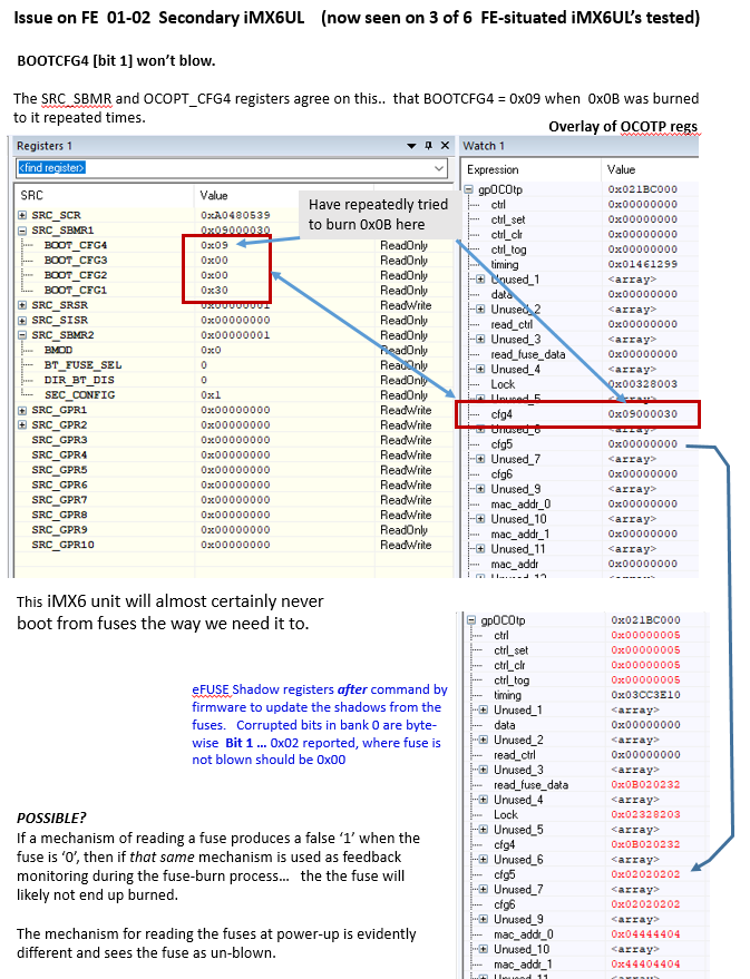

We are now moving ahead to blow eFUSEs in our production PCBs.  Up till now, have done this successfully on bread board systems.   A totally new problem has emerged in this production lot.   We cannot get the right value to burn for BOOTCFG4 on half of our iMX6ULs.   (3 of 6 tested so far,   fail in identical manner).
The malfunction:   We burn BOOTCFG4 = 0x0B, but find upon reset that BOOTCFG4 is 0x09.
Bit 1 is failing to burn.  Full description below.
Could this be component problem??

dbjohnson
More about the faulty behavior:
My assessment of the problem-   when we execute the procedure to burn one or more fuses with our bare-metal burner program running on JTAG,  the fuse-read structure used by  OCOTP software method is being damaged.  This happens on a byte wide basis-- so bytes across all fuse banks will present a common fault on specific bits.  Once the fuse reader has this fault,  I suspect it fools the burn operation for that bit into behaving as if the fuse is already burned.
Thankfully, at power on reset of the iMX6UL, a different scheme interprets the fuses, one that accurately captures the true fuse states to the OCOTP shadows and the SRC_SBMRI.  So on many IMX's the fuse reads are corrupted, but we indeed did burn the correct fuses and the they will boot from eFUSE  (60%)
uboot "out of reach":
As our only boot option on this production board is eFUSE, we'd have to have a way to get a uboot app loaded and running free of eFUSE & JTAG.   Serial boot the only possibility.. but wasn't provided for in our PCB design.  Not to say "impossible", but this would be a tricky hardware effort (aside from the software effort entialed)
JTAG  may be the problem !    Doing JTAG w/o JTAG connection:
                {  Performed on 6 imx6ul's in a row.  Desired fuses burned.  No post-signs of efuse-reader damage }
   -   JTAG in our bare metal efuse-burn firmware  (IAR ARMWB) to virgin IMX^UL
    -   Run to immediate break point
   -    Shut down debug session to release the firmware off the break point.
    -   F/W  executes a 5 sec delay, more than enough time to disengage a pogo pin JTAG physical connect
    -   F/W then completes task of burning fuse .. with imx free of JTAG interactions.

dbjohnson
Thanks!
 I looked at those SRC regs after realizing that my failing IMX6's had EIM I/O's enabled.  The problem had to be unintended boot configuration.  That's when I spotted the mistake in BOOT_CFG1, which needs to be 0x30,  not 0x03!
So the reported fuse configuration in my first post:
OCOTP_CFG4:    0x0B000003   =  BootCFG4 : 0 : BootCFG2 : BootCFG1  for using ecSPI4  with CCS 0 to Serial ROM
       needs to be:  0x0B000030
Lots of eyes here missed that, as perhaps you did too.
And lucky me!   I can burn 0x0B000033 to OCOTP_CFG4.   The lowest 4 bits are "reserved", and to my delight are not factored by the RBL. So I've got all the processors booting ecSPI4/SS0 - Serial NOR from fuses now.
I am still puzzled about the erratic variance chip to chip on software commanded read of fuses. Most of IMX6ULs generate bit errors on READ_FUSE_DATA or just re-loading shadows, yet two of my IMX6ULs read fuses correctly on software command.  Since the shadows are accurate after power-on-reset occurs, most users probably can live with that.
