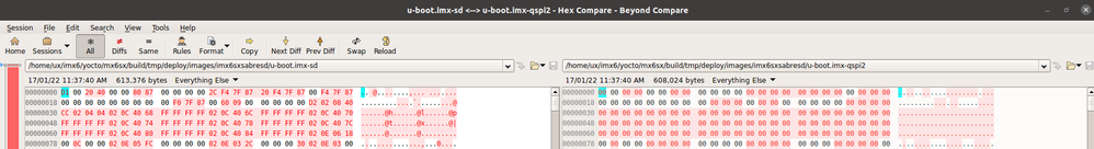

    Recently we've built the U-Boot for i.MX 6SX SABRE-SD's QSPI boot medium. When we try to sign the image for HAB Authentication, we ran into the problem of missing header information.
    We've successfully verfied HAB Authentication earlier for SD Card boot medium. Hence the header comparison of the QSPI vs SD Card U-Boot is shown below:
    So our questions are summarised below,
  1. Is HAB authentication for QSPI?
  2. How could we add the missing imx header information for the QSPI U-Boot?
  3. Is there a provision to get the header details otherwise?

Usually the qspi image contains configuration info in first 0x1000 (0x400) of the image. Thus the IVT header resides at 0x1000. Please adjust the CSF accordingly.
for ex:
Blocks = <address> 0x1000 <size>-0x1000
Make sure the address is pointing at start of IVT and not start of image.

Thanks for the CSF Block specifications. We're already familar with it as we've performed HAB signing and verified it on i.MX 6SX SABRE for SD Card boot medium.
Now our problem is that these block values (i.e., IVT & DCD) are null in our QSPI image.
  1. Do we need to build differently for the QSPI boot medium?
  2. Can you share a reference QSPI U-Boot for i.MX 6SX SABRE-SD that we can sign with CST 3.3.3?
Happy new year!

@Yuri thanks for your commitment and continuous support. I want to list the activites done on this regard and reiterate our problem in hand as follows,
  1. Succesfully built and verified HAB authentication on i.MX 6SX SABRE with SD Card boot medium
  2. Successfully build and verified U-Boot on QSPI boot medium following "IMX_YOCTO_PROJECT_USERS_GUIDE.pdf"
  3. Failed to sign QSPI U-Boot (step 2) due to missing header information.
So, kindly take our experiance/expertise into consideration on answering our current concern as given in step 3.
The header difference between SD and QSPI U-Boot is given in the following picture.
Thanks in advance.

utkarsh_gupta
for ex:

@Yuri & @utkarsh_gupta we've found a variation in imx header on QSPI U-Boot for i.MX 6SX (the size is 0x718 instead of the constant 0xc00).
Kindly refer our new query for more info: https://community.nxp.com/t5/i-MX-Processors/Improper-imx-header-on-QSPI-U-Boot/m-p/1525036/highligh...
8,680件の閲覧回数
utkarsh_gupta
The IVT header in the image built for QSPI should be at offset 0x1000. Do you see the same thing? Are you using NXP BSP to build the image?
