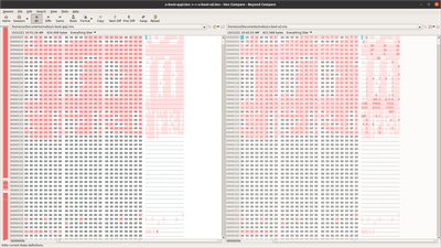

    Recently we've built the U-Boot for i.MX 6SX SABRE-SD's QSPI boot medium. When we try to sign the image for HAB Authentication, we ran into the problem of missing header information.
    We've successfully verfied HAB Authentication earlier for SD Card boot medium. Hence the header comparison of the QSPI vs SD Card U-Boot is shown below:

The header difference between SD and QSPI U-Boot is given in the following picture.
Thanks in advance.
9,866 次查看
utkarsh_gupta
Usually the qspi image contains configuration info in first 0x1000 (0x400) of the image. Thus the IVT header resides at 0x1000. Please adjust the CSF accordingly.
