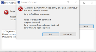

We have a MaaXBoard RT running with iMXRT 1176 with external Octal SPI flash. We have developed driver and created .cfx file.
The driver is verified by using Boot utility tool as well as MCUXpresso GUI Flash tool. We are able to successfully Program/Read/Erase extenal flash. So, the driver seems to be working fine.
We are getting an issue during boot-up after loading application file. The MCU boots to flashloader instead of application file.
Below is the console log displayed:

Error: Wire Ack Fault - target connected?
Vector table SP/PC is the reset context.
PC = 0x00000200
SP = 0x00000200
XPSR = 0x01000000
VTOR = 0x30002000
Set DEMCR = 0x010007F1
============= END SCRIPT ===========================
state - running or following reset request - re-read of state failed - rc Nn(05). Wire ACK Fault in DAP access
following reset read of core registers failed - Ep(08). Cannot access core regs when target running.
Target error from Commit Flash write: Ep(08). Cannot access core regs when target running.
GDB stub (C:\nxp\MCUXpressoIDE_11.6.0_8187\ide\plugins\com.nxp.mcuxpresso.tools.bin.win32_11.6.0.202207121507\binaries\crt_emu_cm_redlink) terminating - GDB protocol problem: Pipe has been closed by GDB.

I'm able to successfully execute the application code(LED blinky), which is stored in external octal flash using the shared mfb project to jump to the application address. The mfb project was selected to "Link application to RAM" configuration in the above process.
What we are trying to do is, to run the external application code without the need of secondary bootloader (mfb project). Can you please help us in this direction?
If we try to debug the application code with the updated FDCB and unchecking the "Link application to RAM", we are still getting same error logs.
Below image is for your reference.

We have further analyzed the logs of RT1170_reset.scp, we found that the "Error: Wire Ack Fault - target connected?" comes soon after the operation "b% = Peek32 This d%", i.e., at the address 0x3000200 where vector table is located.
We have verified the application hex file. The application file has valid vector table at address 0x300200. But the script is not able to read the contents of vector table.
