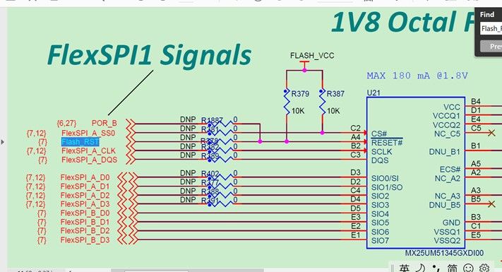

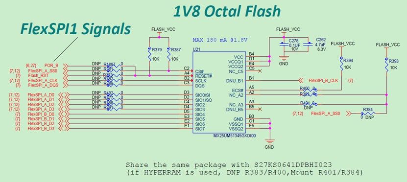

2. Hardware modification
MIMXRT1170-EVK board modify flash to the octal flash, it needs to disconnect the QSPI flash pins, and connect the octal flash pins, the related modification points are:
OPTION2: USE Octal Flash( Mount R381/R378/R382/R389/R402/R377/R388/R391, DNP R380/R399/R386/R390/R392/R385)
Pic 2

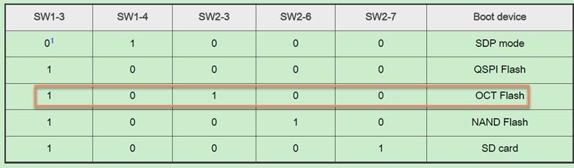

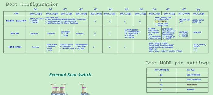

The octal flash BOOT_CFG pin configuration are as follows:
Pic 3
Pic 4
After modifying the hardware related resistors to choose the octal flash, SW1, SW2 should be configured to internal boot, and boot from octal flash, then it is controlled by the software part.

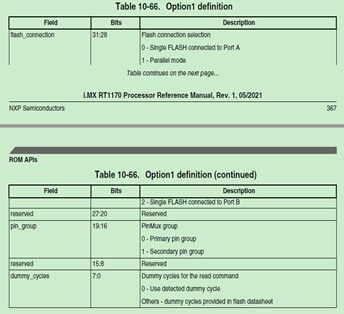

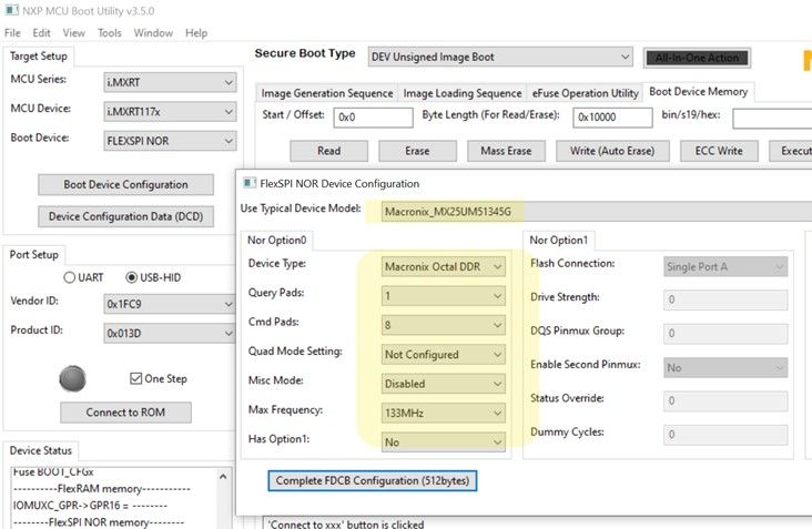

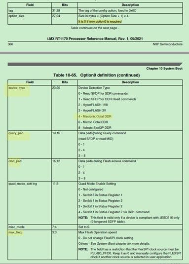

3.1.1 Octal flash option value
Pic 5
We can use the following option0 for testing, don’t need to configure the option1, as the octal flash is connected to the primary pin.
option0= 0Xc0400007, option1 = 0 //query_pad =1, cmd_pad=1,133MHz
option0= 0Xc0433007, option1 = 0 //query_pad =8, cmd_pad=8,133MHz
option0= 0Xc0403007, option1 = 0 //query_pad =1, cmd_pad=8,133MHz

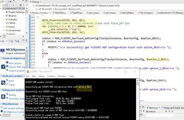

3.1.2 fsl_romapi project testing
   The modified code for the ROM API project are as follows, before call ROM_FLEXSPI_NorFlash_GetConfig API, it needs to use the GPIO to reset the external octal flash at first, so, here add the Flash_RST=GPIO_AD_03=GPIO09_IO02 pin GPIO configuration.
Pinmux.c related code:
gpio_pin_config_t gpio9_pinP15_config = {
      .direction = kGPIO_DigitalOutput,
      .outputLogic = 1U,
      .interruptMode = kGPIO_NoIntmode
  GPIO_PinInit(GPIO9, 02U, &gpio9_pinP15_config);
  IOMUXC_SetPinMux(
	  IOMUXC_GPIO_AD_03_GPIO9_IO02,
      0U);
  IOMUXC_SetPinConfig(
	  IOMUXC_GPIO_AD_03_GPIO9_IO02,//OD,it is a workaround for EVK HW bug
	  0X12);
Flexspi_romapi.c added code:
static serial_nor_config_option_t option_1bit = {
    .option0.U = 0xc0400007U,
    .option1.U = 0U,
static serial_nor_config_option_t option_8bit = {
    .option0.U = 0xc0433007,
    .option1.U = 0U,
static serial_nor_config_option_t option_1_8bit = {
    .option0.U = 0xC0403007,
    .option1.U = 0U,
   GPIO_PinWrite(GPIO9, 02U, 0U);
	// Delay some time to reset external flash with Flash_RST pin
	for (uint32_t i = 0; i < 60000; i++)
		__asm volatile ("nop");
	GPIO_PinWrite(GPIO9, 02U, 1U);
    status = ROM_FLEXSPI_NorFlash_GetConfig(FlexSpiInstance, &norConfig, &option_8bit);
    if (status == kStatus_Success)
        PRINTF("\r\n Successfully get FLEXSPI NOR configuration block with option_8bit\r\n ");
    else
        status = ROM_FLEXSPI_NorFlash_GetConfig(FlexSpiInstance, &norConfig, &option_1_8bit);
            PRINTF("\r\n Successfully get FLEXSPI NOR configuration block with option_1_8bit\r\n ");
        else
            status = ROM_FLEXSPI_NorFlash_GetConfig(FlexSpiInstance, &norConfig, &option_1bit);
              PRINTF("\r\n Successfully get FLEXSPI NOR configuration block with option_1bit\r\n ");
            else
              PRINTF("\r\n Get FLEXSPI NOR configuration block failure!\r\n");
              error_trap();

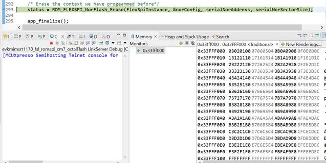

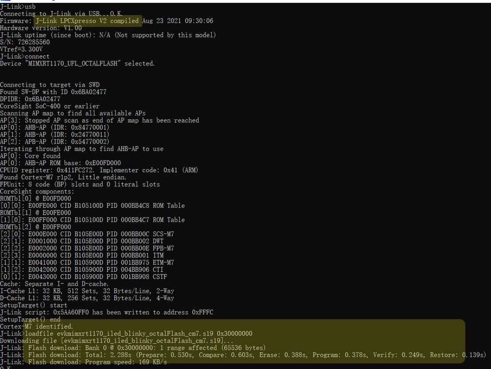

The test result is:
Pic 6
Pic 7
From the test result, we can see, after using the GPIO to reset the external flash, the practical used option value is:
option0= 0xc0403007, option1 = 0 //query_pad =1, cmd_pad=8,133MHz
It can read the SFDP successfully, get the flash config data to the norConfig, then use these values to configure the flexSPI module, at last, it realizes the octal flash related address area erase-write-read-erase operation.
From the above test result, it means, the modified hardware is totally working. Please note, as we can’t confirm the external flash hardware is working, so this project FCB is still the default for the QSPI flash, not the octal flash, then when testing this fsl_romapi project, it’s better to run it from RAM not the external flash.

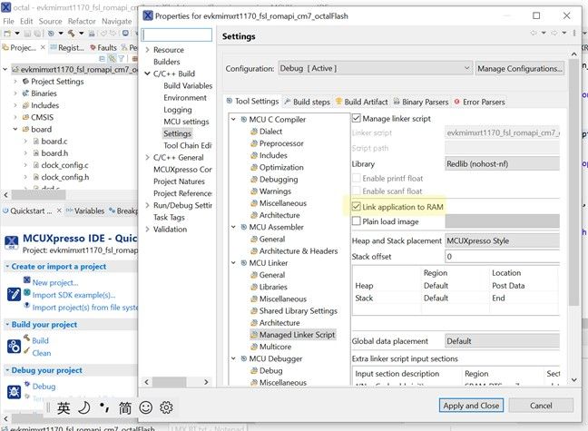

The following picture is how to run the project from the internal RAM, not download the flash directly:
Pic 8

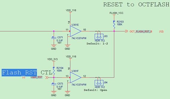

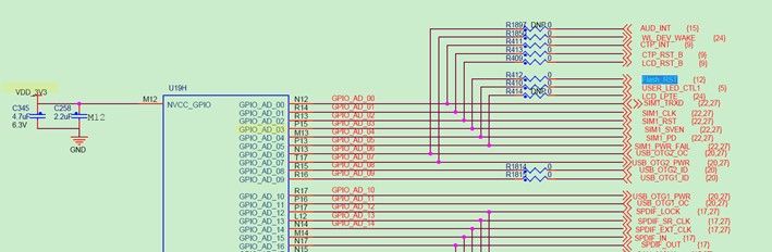

   Here, for the configuration, we also have one point that needs to note, why configure the GPIO pin Flash_RST: GPIO_AD_03 as OD(open drain)?
   It is caused by the current MIMXRT1170-EVK hardware having a bug, so this OD configuration is used as the workaround. Octal flash MX25UM51345GXDI00 power supply voltage is 1.8V, but the GPIO_AD_03 bank voltage is 3.3V, between these two modules, no voltage convert hardware, so it will have the following situation:
a) Default GPIO_AD_03 is input mode, this pin has the internal PD(pull down) 35K resistor,  and the external PU(pull up) 10K resistor to the 1.8V, Flash_RST=1.8V*35K/(10K+35K)=1.4V, this voltage also can be used as the enable signal.
To the normal boot, as the ROM didn’t control the octal flash Flash_RST pin, then this pin can be freely chose by any pin in the practical usage, so, the reset pin default is input, the voltage is 1.4V, it can enable the octal flash, no influence.
b) When need to control the octal flash reset, then it needs to use the GPIO control GPIO_AD_03 pin, if want to output 0, it is OK. But if want to output high level, use the internal PULL resistor, it will output 3.3V to the Flash_RST pin, this voltage already higher than the octal flash 1.8V, and the octal flash datasheet defines the max voltage is 2V, although the flash chip has the voltage buffer, input 3.3V in short time, won’t damage the chip, but after long time working, the chip normal working can’t be guaranteed, this will cause the risk. So, to solve this issues, we can do some workaround in the flashloader, rom API, when output the Flash_RST pin to higher, we can use OD mode, then the detail pin voltage is totally determined by the external pull circuit, and the EVK also have the external 10K PU to 1.8V, so it can output 1.8V not the 3.3V.
Pic 9
  In the NXP new MIMXRT1170-EVKB board, the hardware adds the voltage convert chip to solve these issues, it can realize the 3.3V and 1.8V conversion:
Pic 10

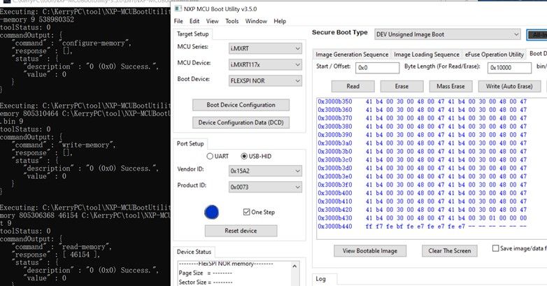

3.2 MCUBootUtility program octal flash
We can use the MCUBootUtility to test MIMXRT1170-EVK+octal flash in serial download mode, normally for the chip connect, memory erase, read and program. This method also can use the tool to generated the correct FCB header for the octal flash, then can test the boot situation in the internal boot mode.
Serial download-> SW1:1-OFF,2-OFF,3-OFF,4-ON
Internal boot-> SW1:1-OFF,2-OFF,3-ON,4-OFF
The MCUBootUtility configuration is:
Pic 11
This configuration is: option0=0Xc0403007,query 1wire, cmd 8 wire.
Then app image can use the MCUBootUtility attached code:
NXP-MCUBootUtility-3.5.0\apps\NXP_MIMXRT1170-EVK_Rev.A\cm7\led_blinky_0x3000a000.srec
Pic 12
  We can see, the code downloading is finished, after this, reset device, configure the board as internal boot mode, then do the POR or the HW reset, we can see the on board LED D34 is blinking, it means the hardware also can boot from the octal flash.

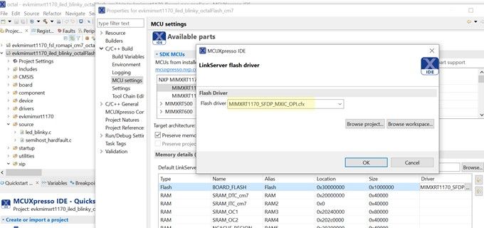

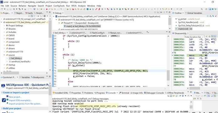

4. CMSIS DAP Flashloader

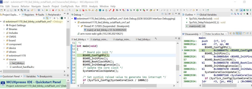

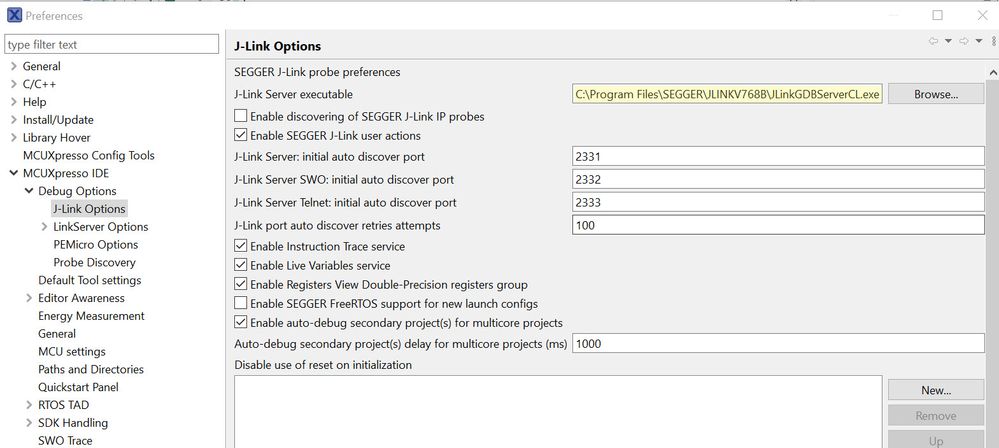

MIMXRT1170-EVK default use the CMSIS DAP debugger, take the MCUXPresso IDE as an example, it will call the flashloader named as .cfx file, flashloader source code can be found from this path:
C:\nxp\MCUXpressoIDE_11.6.0_8187\ide\Examples\Flashdrivers\NXP\iMXRT\ iMXRT117x_FlexSPI_SFDP.zip
The exist .cfx file which can be used directly, the path is:
C:\nxp\MCUXpressoIDE_11.6.0_8187\ide\binaries\Flash\
MIMXRT1170_SFDP_QSPI.cfx:  QSPI flash
MIMXRT1170_SFDP_MXIC_OPI.cfx: octal flash
Pic 13
When use flashloader + CMSIS DAP + MCUXpresso debug result is:
Pic 14

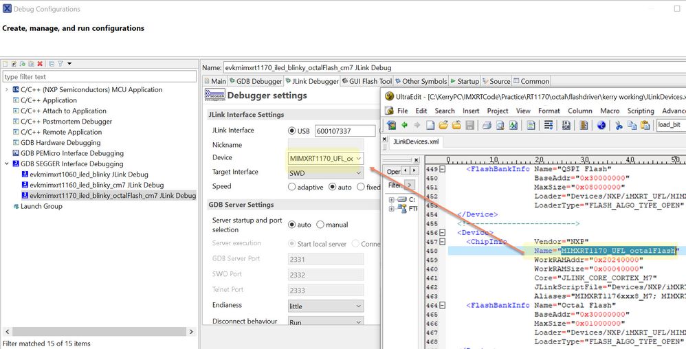

One point need to note, mcuxpresso IDE flashloader source code iMXRT117x_FlexSPI_SFDP.zip, the project configured to the octal flash, the related Flash_RST control code need to be modified, otherwise, when it output high, the voltage will be 3.3V.
Pic 15
In the above picture,
add code:
MEM_WriteU32(0x400E835CU, 0x12);
Which is SW_PAD_CTL_PAD_GPIO_AD_03 register = 0x12, OD mode, then generate the mxic MX25UM51345GXDI00 octal flash .cfx file again, which is used for the mcuxpresso+CMSIS DAP debugger.

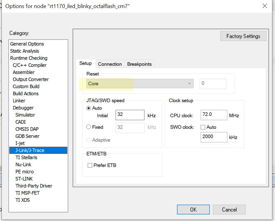

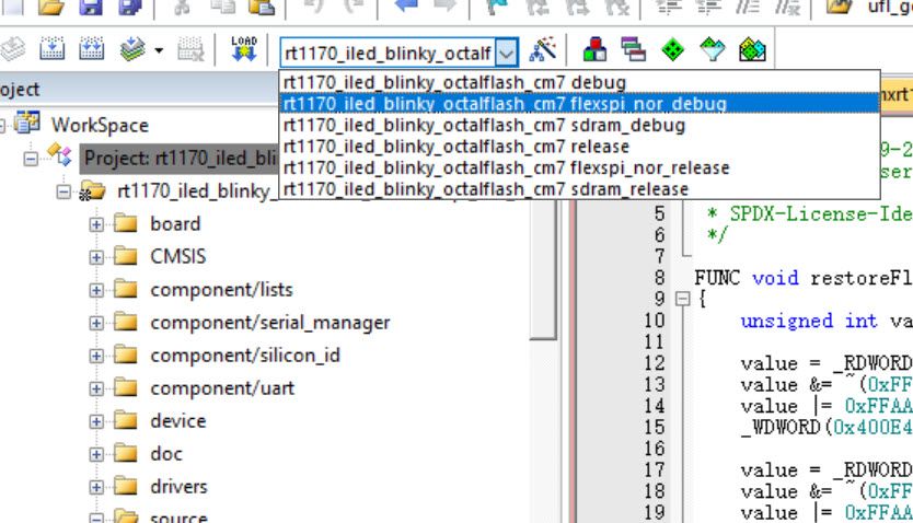

5. JLINK Flashloader with RT-UFL
In actual use, many customers not only use the on-board CMSIS-DAP debugger, but also like to use external JLINK/JLINK plus, or use the on-board JLINK firmware (use LPCScrypt modify firmware, pay attention to update the JINK firmware according to the instructions on the webpage), or use the external JLINK firmware (need to disconnect the onboard debugger jumper). But if the JLINK flash driver is called directly, it will be QSPI flash. Here is how to use the flash driver of the octal flash in JLINK. Now the JLINK driver uses JLinkARM.dll to define the flash used by different chips, unlike the old JLINK driver. The firmware of the flash is called by JLinkDevices.xml. The .dll file cannot allow users to directly modify the corresponding flash of the device, so it is necessary to provide a flash driver file that supports RT1170 octal flash, and add a calling command in JLinkDevices.xml to override the default QSPI definition in JLinkARM.dll.
NXP FAE has developed a very useful full-function flash driver called RT-UFL, which can support general QSPI, hyperflash, octaflash, etc. Users can use JLINK to call RT-UFL flash driver, and then use JFLASH, JLINK commander, or IDE (MCUXpresso, IAR, MDK) to realize the debugging and downloading of RT chips combined with different flashes
RT-UFL download link:
https://github.com/JayHeng/RT-UFL
More detail usage of RT-UFL, please check this blog link:
https://www.cnblogs.com/henjay724/

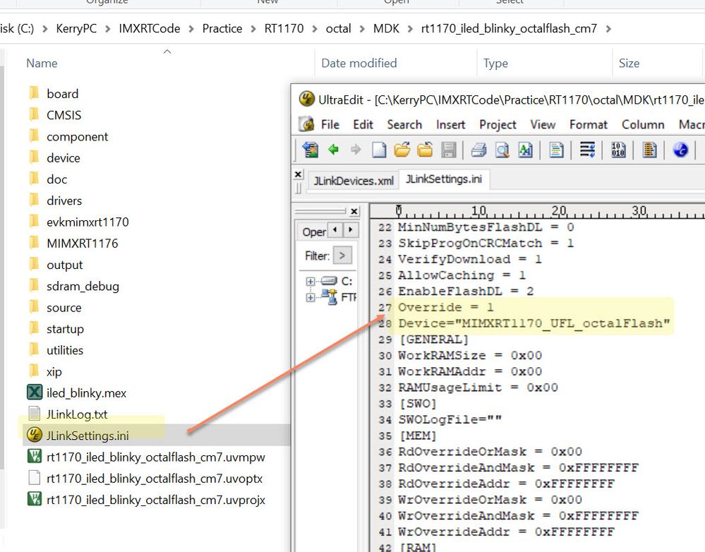

After downloading, install the RT-UFL to the JLINK driver, copy the following folder file:
RT-UFL-1.0\algo\SEGGER\JLink_Vxxx
to the JLINK driver install path:
C:\Program Files\SEGGER\JLINKV768B
The JLINK driver link is:
https://www.segger.com/downloads/jlink/JLink_Windows_x86_64.exe

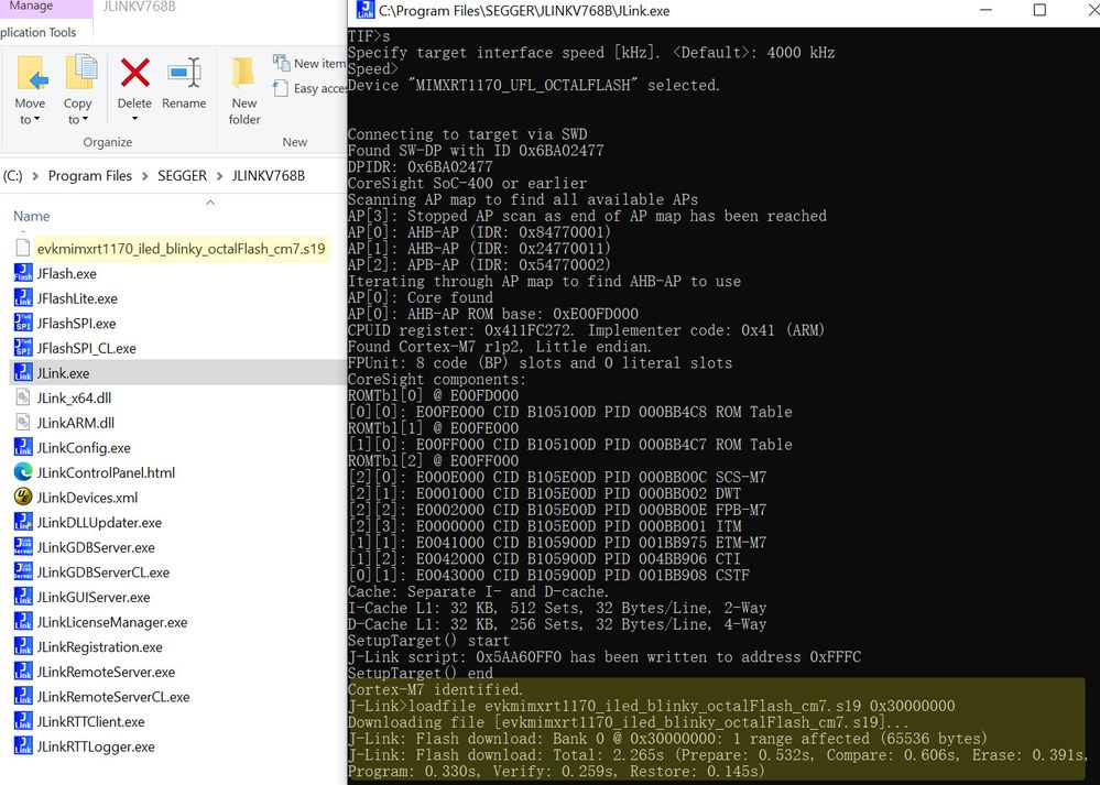

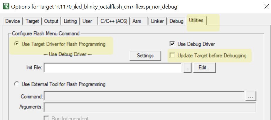

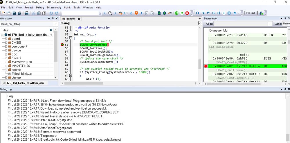

Now, use the original RT-UFL firmware combined with JFLASH to test the octal flash in RT1170 directly, and the debugger is JLINK plus, just to check whether it can be run, device selection: MIMXRT1170_UFL_L0.
_L0 suffix algorithm is suitable for QSPI Flash and Octal Flash (Page size is 256 Bytes, Sector size is 4KB), _L1/2 suffix algorithm is suitable for Hyper Flash (Page size is 512 Bytes, Sector size is 4KB/64KB).
5.1 RT-UFL JFlash Test

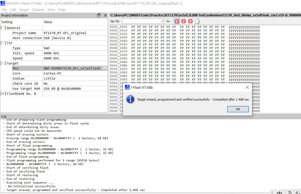

Generate a .srec file for the led_blinky project which FCB has been modified to octal flash before, it will be used by JFLASH or JLINK commander later.
Use JFLASH combined with JLINK plus to create a new JFLASH project. The chip is selected as MIMXRT1170_UFL_L0 which can support octal flash.

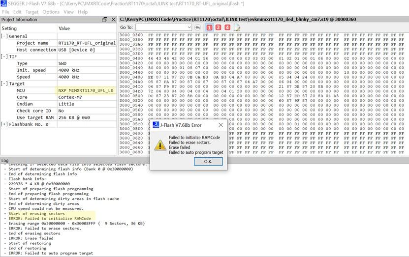

The test situation is as follows, you can see that the connect can be successful, and the ARM CortexM7 core can be found, but the programming, reading, and erasing functions will fail. It can be said that the connection to the external octal flash is not successful at all:
Pic 16

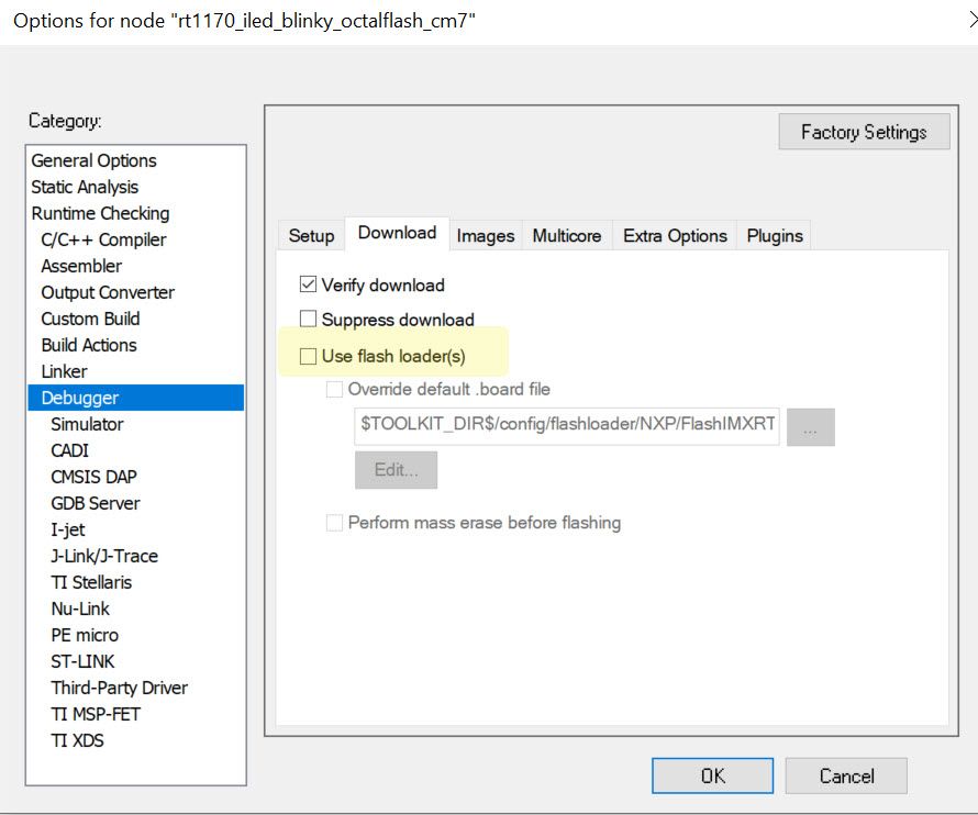

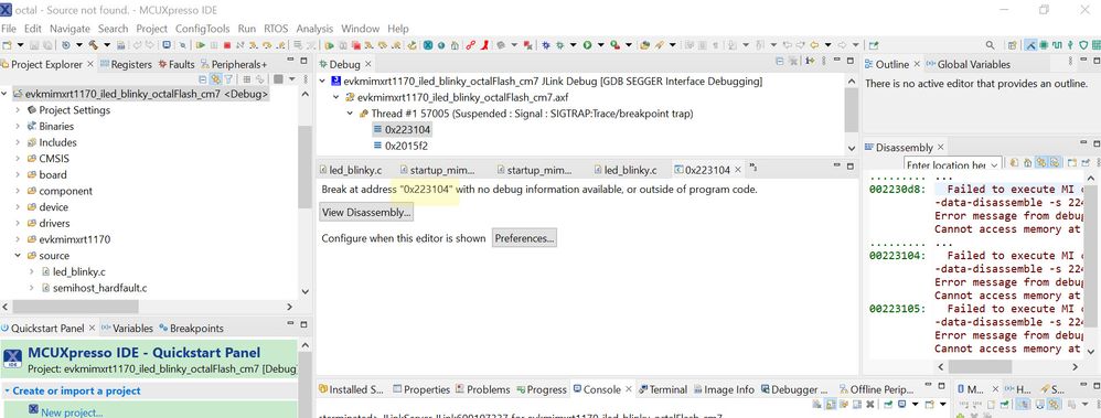

If the used JLINK is not the JLINK plus, due to the license can’t support the JFLASH, then customer can use the JLINK commander to test it, but here, the test result with the original RT-UFL is totally the same as the JFLASH:
Pic 17
It can still meet the issues of “Failed to initialize RAMCode”, even use the mem32 readout the address data, sometimes, the data is not correct, not the real flash data, customer can compare the memory which the data which is readout from the MCUBootUtility.
So, the RT-UFL flashdriver code need to be modified to the octal flash, to let the octal flash works.

1) RAMCode errors
In the JLinkDevices.xml file, define the RAM location to the OCRAM address:
 <Device>
    <ChipInfo      Vendor="NXP"
                   Name="MIMXRT1170_UFL_octalFlash"
                   WorkRAMAddr="0x20240000"
                   WorkRAMSize="0x00040000"
                   Core="JLINK_CORE_CORTEX_M7"
                   JLinkScriptFile="Devices/NXP/iMXRT_UFL/iMXRT117x_CortexM7.JLinkScript"
                   Aliases="MIMXRT1176xxx8_M7; MIMXRT1176xxxA_M7" />
    <FlashBankInfo Name="Octal Flash"
                   BaseAddr="0x30000000"
                   MaxSize="0x01000000"
                   Loader="Devices/NXP/iMXRT_UFL/MIMXRT_FLEXSPI_UV5_UFL.FLM"
                   LoaderType="FLASH_ALGO_TYPE_OPEN" />
  </Device>

5.2.2 JFlash Test
As can be seen from the test results of Jflash below, it can be successfully erased, and the app image can be downloaded to octal flash. After the download is successful, reset it, and you can see the onboard led is flashing. It shows that the modified RT-UFL flashloader has worked. It should be noted here that the use of JFLASH requires the use of an external Segger JLINK Plus. Some customers use normal JLINK or RT EVK onboard JLINK firmware, then they can try the JLINK commander method.
Pic 18
5.2.3 JLINK command Test
Use the JLINK plus associated with JLINK commander test result is:
Pic 19
You can see that the firmware can be downloaded successfully.
Now uses the EVK onboard JLINK firmware to test as follows, it can be seen that the programming is normal, so if users don’t have external JLINK can also directly use the RT EVK onboard JLINK firmware. One thing need to pay attention to is when using the onboard JLINK firmware, the firmware will cause the debugger port USB to not directly supply power to the RT chip, so it needs to be configured that J38 is connected to 3-4, and then find another USB cable to connect J20 to supply power to the board.
Pic 20
5.3 MCUXpresso + JLINK +Modified RT-UFL Testing
At first, select the MCUXPresso IDE JLINK debug path, add the JLINK driver path which is already added RT-UFL firmware, window->preferences, then the path should like this:
Pic 21
When downloading, still need to configure RUN->Debugger configurations, the JLINK configuration should be:
Pic 22

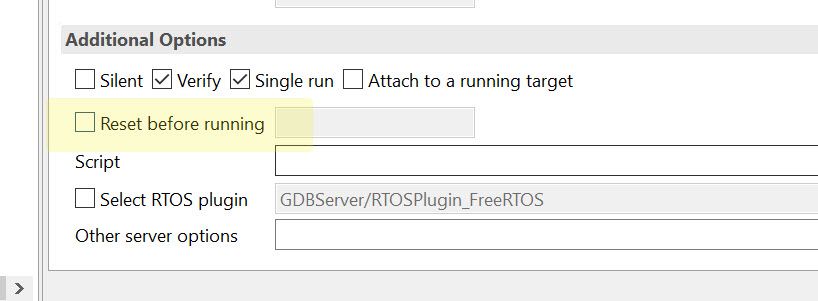

Please note, don’t check the item “Reset before running” in the debug configuration, as this item is checked in default.
Pic 23
If checked “Reset before running”, when debug it, the code will be blocked after downloading the code, and can’t jump to the main function. If customer click halt button, it will meet the issues that the code is stop at 0x223104, but after exit the debug mode, and do the POR again, you will find the flash already downloaded with the app successfully.
Pic 24
This problem is related to the impact of RT1170 security policy on JLINK. For details, please refer to the following link:
https://www.cnblogs.com/henjay724/p/15725966.html
When JLink is connected to the chip, as long as the reset command is executed, it will directly enter the safe debugging mode (the PC stops at 0x223104).
Therefore, make sure that "Reset before running" is not checked, so that you can enter the debug and main functions normally, and the test results are as follows:
Pic 25
5.4  MDK+JLINK+Modified RT-UFLTesting
Next, use the MCUXPresso CFG tool combined with the SDK package to export an MDK project, also based on the led_blinky project, and modify the FCB code for Octal flash, and then call the modified RT-UFL flashloader, the device name is: MIMXRT1170_UFL_octalFlash.
Note, be sure to refresh:
C:\Program Files\SEGGER\JLINKV768B\JLinkDLLUpdater.exe
Make sure the IDE is using the latest firmware link.
The following is a specific MDK project related configuration pictures:
Pic 26

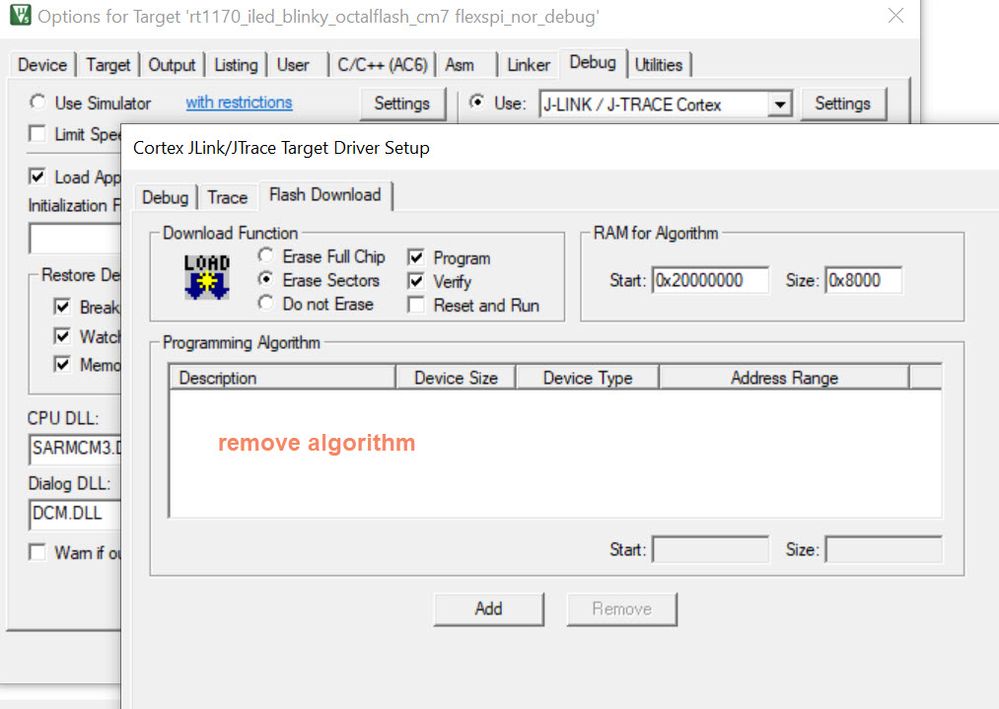

The project is selected as flexspi_nor_debug, and after compiling, the debug tool is configured as JLINK, the JLINK simulation sequence can be found, and the updated target before debugging in utilities should not be checked:
Pic 27
Pic 28
Pic 29
Modify JlinkSettings.ini,configure override =1, device as the RT-UFL modified firmware device name: MIMXRT1170_UFL_octalFlash.
Pic 30
Pic 31
As can be seen from the above picture, the modified RT-UFL Octal flash has been successfully used to run the MDK project.
It should be noted that do not use the download button, because this button cannot use the overwritten and modified RT-UFL programming algorithm, it will still call the programming algorithm of the deleted area of ​​the interface, and an error will be reported if it cannot be found.
5.5 IAR + JLINK + Modified RT-UFL Testing

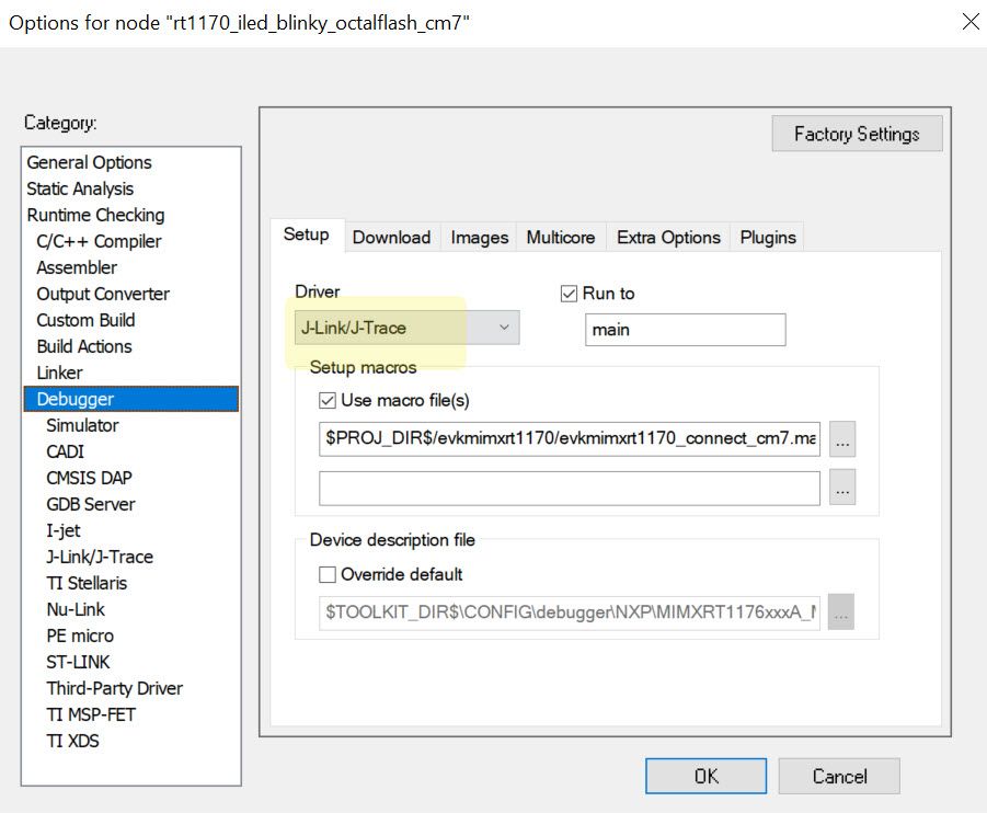

Here is the use of IAR combined with JLINK to debug RT1170 octal flash, using the modified RT-UFL programming algorithm. The specific configuration is as follows:
Pic 32
Don’t check “use flash loaders”, it means don’t use the IAR attached .out download algorithm, and use the JLINK driver’s modified RT-UFL octal flash flashdriver.
Pic 33
Reset can choose core, if it is normal, debug will meet the same issues with the MCUXPresso which checked reset item, PC will stop to 0x223104.
Pic 34
Here, modify project settings folder ->.jlink file, use the RT-UFL device name: MIMXRT1170_UFL_octalFlash,
And override =1, then it will call the modified RT-UFL flashloader. If you can’t find the .jlink in the new created project, just select the JLINK debugger, click download at first, then it will generate the .jlink file, then modify it and debug it again.
Pic 35
After modify the RT-UFL program algorithm to the octal flash, click “download and debug” button, it will enter the debug mode, in the following picture, the code is running successfully:
Pic 36
