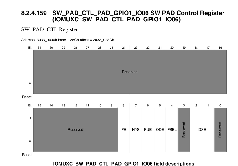

hello
could you please help me out to configure GPIO1_IO6  with internal PULLUP . below are the DTB contents i found relevant to the GPIO configuration which i'll be using in my driver.
By default we are getting line in pulled LOW state now. we need to configure in pulled high state by default.
https://source.codeaurora.org/external/imx/linux-imx/tree/arch/arm64/boot/dts/freescale/imx8mp-pinfu...
* The pin function ID is a tuple of
* <mux_reg conf_reg input_reg mux_mode input_val>
#define MX8MP_IOMUXC_GPIO1_IO06__GPIO1_IO06   0x02C 0x28C 0x000 0x0 0x0
https://source.codeaurora.org/external/imx/linux-imx/tree/arch/arm64/boot/dts/freescale/imx8mp-evk.d...
&iomuxc {
              pinctrl_csi0_rst: csi0_rst_grp {
                              fsl,pins = <
                                             MX8MP_IOMUXC_GPIO1_IO06__GPIO1_IO06  0x19
to my understanding the value 0x19 is writing to the below control register which is setting the GPIO to use as PULLDOWN.
where bit no:8 =0 and bit no:6=0.
Screenshot from 2021-09-03 20-20-57.pngScreenshot from 2021-09-03 20-20-57.png
is this the right approch, please help me understand it correctly.
Thanks in advance

Hi Mukesh
>setting the GPIO to use as PULLDOWN. where bit no:8 =0 and bit no:6=0.
for enabling pull resistor set bit no:8 =1
enable pull down(LOW)  bit no:6=0
enable pull up(HIGH)      bit no:6=1
igor

mukesh_kumar
Hi igor,
Thank you for replying to the issue.
I changed the value as 1 at bit number 6 and bit number 8 , but it seems not taking any effect to change as internal pullup
&iomuxc {
                              fsl,pins = <
                                             MX8MP_IOMUXC_GPIO1_IO06__GPIO1_IO06  0x159
for confirmation I tried reading register address 0x3033028C using devmem2, but it thrown a error mentioning bad address.
can you please answer the following queries
1.Does the control register I'm referring to is correct?
2.what is the correct physical address of the register that refer the preprocessor directive MX8MP_IOMUXC_GPIO1_IO06__GPIO1_IO06 ?
3.At the defination of this preprocessor directive the tuple contains a member named input_val, is it input to mux_reg or conf_reg ?
/* <mux_reg conf_reg input_reg mux_mode input_val>
can you please answer these queries,
Thank you,
Mukesh kumar

igorpadykov
devmem2 is not supported by nxp, please try memtool

mukesh_kumar
Hi igor,
I'm able to see that register contents are updating properly,
i also changed the drive strength field as well from X1 to X6 that helped to drive the pullup to 1.8V for me.
while the drive strength field is set X1 the pullup is able to drive 0.5V only.
thanks for the help.
