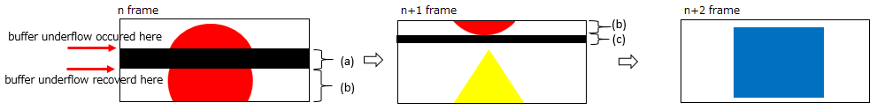

About the behavior when buffer underflow happen in LCDIF
I understood that LCDIF will recover from the buffer underflow state by LCDIF_CTRL1n[RECOVER_ON_UNDERFLOW] setting.
In this thread, I would like to confirm the video output from LCDIF in the buffer underflow state.

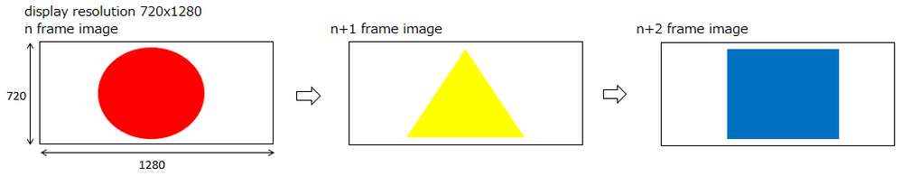

I assume that video is output to the LCD via LCDIF and video is displayed in the order shown in the figure below.
Q1. I guess that when the buffer underflow occurs, it will be displayed as following figure. Is my understanding correct?
(a) : LCDIF can not output any data during the buffer underflow state. therefore, the display become black screen.
(b) : LCDIF output remaining frame data.
(c) : LCDIF does not output any data during a blanking interval. thefefore, the display become black screen.
Q2. Which frame is recovered from the buffer underflow state and display back to normaly? n+2 frame or n+1 frame like a following figure?
In case of n+2:
In case of n+1:

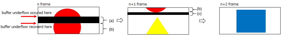

LCDIF can not output data to display during buffer underflow state. also, the remained data too.
therefore, LCD displayed like a following figure. Is it right?
pastedImage_3.png‌
(a) : LCDIF can not output any data during the buffer underflow state. the display become black screen.
(b) : LCDIF can not output remaining frame data. the display become black screen.

We can't confirm what will happen in display side, different display can show different result when input signal is not correct.
What we can confirmed is that, after buffer underrun, the DE(data enable) signal will be invalid untill next frame.
