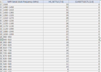

refer to your sensor data, it seems csis-hs-settle = <31>; is too high, pls refer to the table as below and set the correct data

Btw, do you mean that `csis-hs-settle=31` is too high for iMX8MP to handle because as I said  the output of the selected mode of my sensor was 1440Mbps which is in the range of 1440~1410 (correspond to HS_SETTLE[7:0]=31) but you said csis-hs-settle=31 is not correct makes me confused  about the table you provided.
Khang.
6,217 Views
joanxie
this table is for serial clock, 1440MBPS you  mentions isn't the serial clock, that's why I suggest that you try the lower value, you can try the 15 and test again

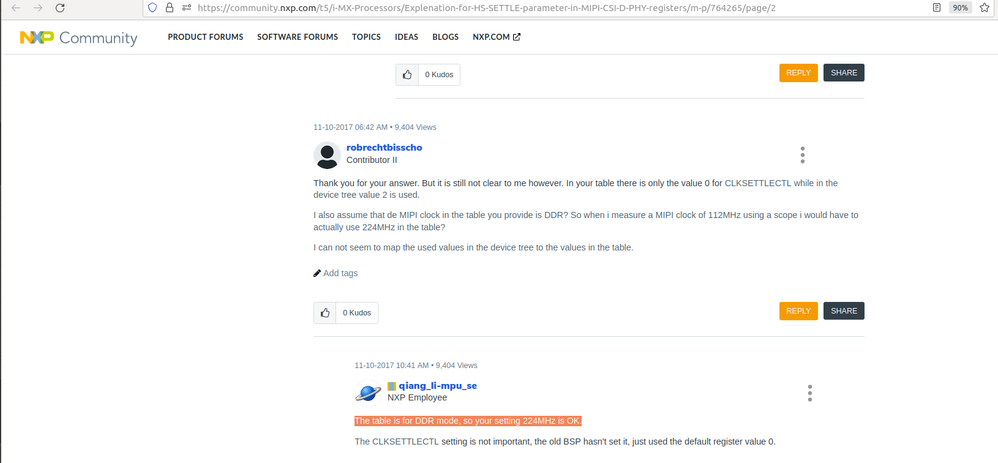

From the following discussion : https://community.nxp.com/t5/i-MX-Processors/Explenation-for-HS-SETTLE-parameter-in-MIPI-CSI-D-PHY-r... with the answer of you colleague :
I understood differently : for clock freq 720MHz --> value in the table should 720 * 2 = 1440MHz then csis-hs-settle=31. What do you think?

joanxie
yes this depends on ddr mode, but according to my experience, it seems this table isn't correct enough, you may try the other value again

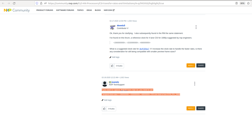

I saw your advice about the `assign-clock-rates` for MIPI-CSI2 from following discussion : https://community.nxp.com/t5/i-MX-Processors/CSI-transfer-rates-and-limitations/m-p/995950
For being able to capture 4K, would it still be valid for the BSP-5.4.70-2.3.2 that I am using seeing the configuration of mipi_csi nodes are as below (arch/arm64/boot/dts/freescale/imx8mp.dtsi) :
