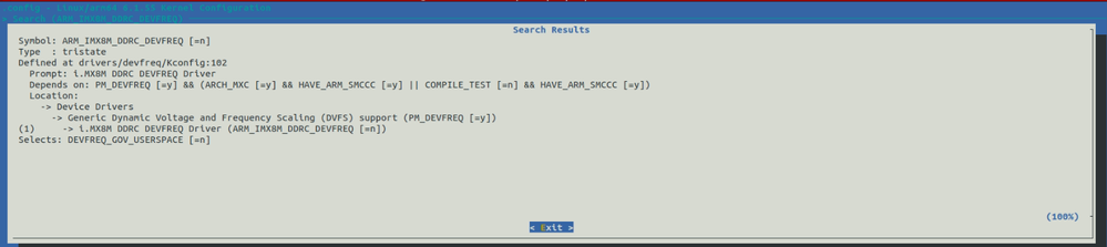

I searched a solution for disabling the DDR frequency scaling policy during the compiling of the firmware image and found 2 possibilities :
1. Following the similar instruction for iMX6 to modify the iMX busfreq driver, but for the iMX8M family, the driver source file seem to be : <linux-imx>/drivers/soc/imx/busfreq-imx8mq.c (based on the fact that the printed log is found within this file). Can you confirm as this looks more specific to iMX8MQ ?
2. Disabling completely the dynamic scaling for imx8m ddr controller by setting the ARM_IMX8M_DDRC_DEVFREQ token in the kernel default config to n(o).  This should be more generic for iMX8M family, however the token is not explicitly defined/set to y(es) or m(odule). What do you think?

Chavira
HI @khang_letruong!
1>> The driver busfreq-imx8mq.c is for iMX8M family, you can consult this information on LINUX REFERENCE MANUAL .
2>> You can disable the frequency scaling directly on  the driver like the iMX6 instructions is not required to add any configuration in kernel.

khang_letruong
Senior Contributor III
Hi @Chavira ,
I tested modifying the <linux-imx>/drivers/soc/imx/busfreq-imx8mq.c  similar to the case of iMX6 and it worked. Also this is the only option as ARM_IMX8M_DDRC_DEVFREQ is already deselected (i.e. n) in the default kernel configuration :
