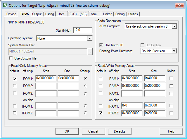

Please also compare the options for the Target

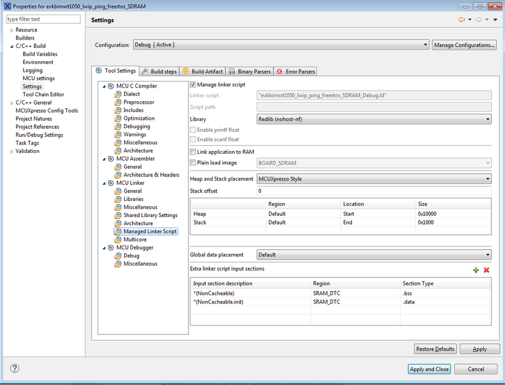

In your link file, you should have a non cacheable region to hold the buffers.
The non-cacheable region can be in SDRAM, or in SRAM_DTC.
There is a demo with LWIP in SDRAM.
Please refer to
SDK_2.7.0_EVKB-IMXRT1050\boards\evkbimxrt1050\lwip_examples\lwip_httpscli_mbedTLS\freertos\mdk
I hope it helps.

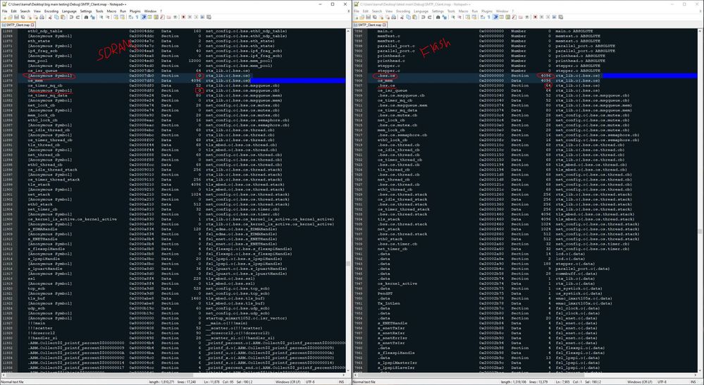

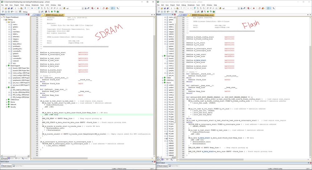

I have looked at the example you recommended and it does work in SDRAM. The problem is my code uses Keil RTX5 RTOS and the working example uses FreeRTOS. I have tried to adjust my code to work with FreeRTOS but I cannot get it to work. I need to use the Keil RTOS RTX5 to be able to access the SMTP functions.
Also, I do not have these lines of code in my Keil RTX5 project:
    SDK_ALIGN(static rx_buffer_t rxDataBuff_0[ENET_RXBD_NUM], FSL_ENET_BUFF_ALIGNMENT);
    SDK_ALIGN(static tx_buffer_t txDataBuff_0[ENET_TXBD_NUM], FSL_ENET_BUFF_ALIGNMENT);
Change to:
  AT_NONCACHEABLE_SECTION_ALIGN(static rx_buffer_t rxDataBuff_0[ENET_RXBD_NUM], FSL_ENET_BUFF_ALIGNMENT);
  AT_NONCACHEABLE_SECTION_ALIGN(static tx_buffer_t txDataBuff_0[ENET_TXBD_NUM], FSL_ENET_BUFF_ALIGNMENT);
After adjusting my code while keeping Keil RTX5, I created the scatter file that almost matches the working project. In the .map file screenshots, you can see the left side is my non working project and the right side is working. I moved the network files to DTC memory just like the working project. For some reason I am missing the .bss files?
The working project runs in Flash and the scatter files are similar. Do you know how to fix the issue with the missing .bss files?
