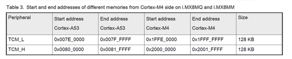

we want to use the Cortex-M4 of the iMX8MMINI # in our application. Currently I'm going through the reference manual and the SDK examples. Running the demo binaries from U-Boot also works.
I've several questions for which I can't find answers in the reference manual or other documents. For example, the M4 can be booted from different devices (TCM, DDR, etc.), but it's nowhere mentioned how the mechanism for this is implemented - I assume the U-Boot bootaux command sets some special registers for the boot address, but where is this documented?

sorry for the late reply. Maybe you can at least clarify why the examples from SDK link the code region to CM4 address 0x1FFE0000 instead of 0x00000000. I understand that TCML from 0x00000000-0x0001FFFF is mirrored at this address. Usually CMx software is linked to 0x00000000 and  I think it should also work. What is the reason for linking to 0x1FFE0000?

Raal
Hello @joanxie
I know this document. According to the iMX8MM reference manual, chapter 2.1.3 "Cortex-M4 memory map" the TCM is mapped as follows:
So this fits to the link address of 0x1FFE0000. But there's also a TCML mirror at 0x00000000:
Theoretically a M4 image should also be able to run if linked to address 0x00000000, right?

joanxie
yes,  The area (0000_0000) and area (1FFE_0000) in CM4 are aliases.
