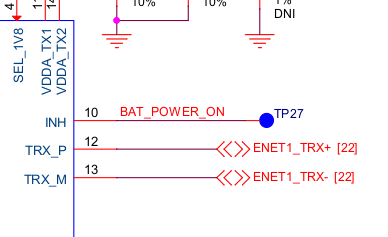

Please close this ticket.
It is a hardware issue.
The problem with Diode introduces in the following lines CONN_ETH_TRX_P and CONN_ETH_TRX_N for protection purpose because of that link is not detected.
After removing those two diodes, link is detected and ethernet is working.
Vinothkumar Sekar

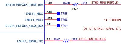

Currently TJA1101 AUTO-PHY connect with phy0 of the IMX8QM custom board.
I am doubt about clock,
ENET0_REFCLK_125M_25M I cannot use because it is DNP.
For phy Master, Which one I have to configure (CLOCK_IN or CLOCK_OUT) ENET0_RGMII_TXC ?
IMX8QM_ENET0_RGMII_TXC_CONN_ENET0_RCLK50M_IN
(or)
IMX8QM_ENET0_RGMII_TXC_CONN_ENET0_RCLK50M_OUT
Vinothkumar Sekar

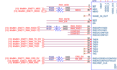

I'm trying to integrate TJA1101 Phy with IMX8M Custom board as 2 -wire ethernet interface. I'm also not able to get the link up.

&fec {
        pinctrl-names = "default";
        pinctrl-0 = <&pinctrl_fec>;
        phy-mode = "rmii";
        phy-handle = <&ethphy1>;
        fsl,magic-packet;
        status = "okay";
        phy-reset-gpios = <&gpio3 0 0>;
        phy-reset-duration = <10>;
        mdio {
                #address-cells = <1>;
                #size-cells = <0>;
                ethphy1: ethernet-phy@0 {
                        compatible = "ethernet-phy-ieee802.3-c22";
                        reg = <0>;
                        tja110x,refclk_in;
       pinctrl_fec: fecgrp {
                fsl,pins = <
                        MX8MP_IOMUXC_SAI1_RXD2__ENET1_MDC               0x3
                        MX8MP_IOMUXC_SAI1_RXD3__ENET1_MDIO              0x3
                        MX8MP_IOMUXC_SAI1_RXD4__ENET1_RGMII_RD0         0x91
                        MX8MP_IOMUXC_SAI1_RXD5__ENET1_RGMII_RD1         0x91
                        MX8MP_IOMUXC_SAI1_TXD7__ENET1_TX_ER             0x1f
                        MX8MP_IOMUXC_SAI1_TXD4__ENET1_RGMII_TX_CTL      0x1f
                        MX8MP_IOMUXC_SAI1_TXD0__ENET1_RGMII_TD0         0x1f
                        MX8MP_IOMUXC_SAI1_TXD1__ENET1_RGMII_TD1         0x1f
                        MX8MP_IOMUXC_SAI1_TXFS__ENET1_RGMII_RX_CTL      0x91
                        MX8MP_IOMUXC_SAI1_TXD6__ENET1_RX_ER             0x1f
                        MX8MP_IOMUXC_SAI1_MCLK__ENET1_TX_CLK            0x3
/*                      MX8MP_IOMUXC_SAI1_RXD6__ENET1_RGMII_RD2         0x91 */
/*                      MX8MP_IOMUXC_SAI1_RXD7__ENET1_RGMII_RD3         0x91 */
/*                      MX8MP_IOMUXC_SAI1_TXC__ENET1_RGMII_RXC          0x91 */
/*                      MX8MP_IOMUXC_SAI1_TXD2__ENET1_RGMII_TD2         0x1f */
/*                      MX8MP_IOMUXC_SAI1_TXD3__ENET1_RGMII_TD3         0x1f */
/*                      MX8MP_IOMUXC_SAI1_TXD5__ENET1_RGMII_TXC         0x1f */
/*                      MX8MP_IOMUXC_SAI1_RXD0__GPIO4_IO02              0x19 */
Im able to set the static IPs in 2 identical boards and not able to ping.
Is there any application/utility for read/write the PHY registers.
Also we have provided an ESD  and common mode filter . Could you please confirm if its the same case with yours?
Any help is appreciated.
