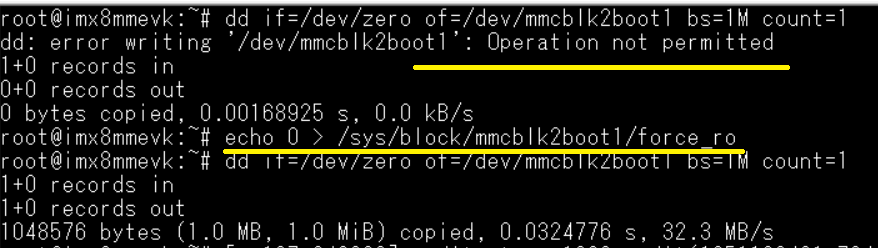

Under Linux, the boot partition default is read only.
Because the script write bootload in u-boot, so it comment the way write bootloader under linux.

# you can enable below command to write boot partition. but offset is difference at difference platform
#FBK: ucmd mmc=`cat /tmp/mmcdev`; echo 0 > /sys/block/mmcblk${mmc}boot0/force_ro
#FBK: ucp _flash.bin t:/tmp
#FBK: ucmd mmc=`cat /tmp/mmcdev`; dd if=/tmp/_flash.bin of=/dev/mmc${mmc}boot0 bs=1K seek=32
#FBK: ucmd mmc=`cat /tmp/mmcdev`; echo 1 > /sys/block/mmcblk${mmc}boot0/force_ro

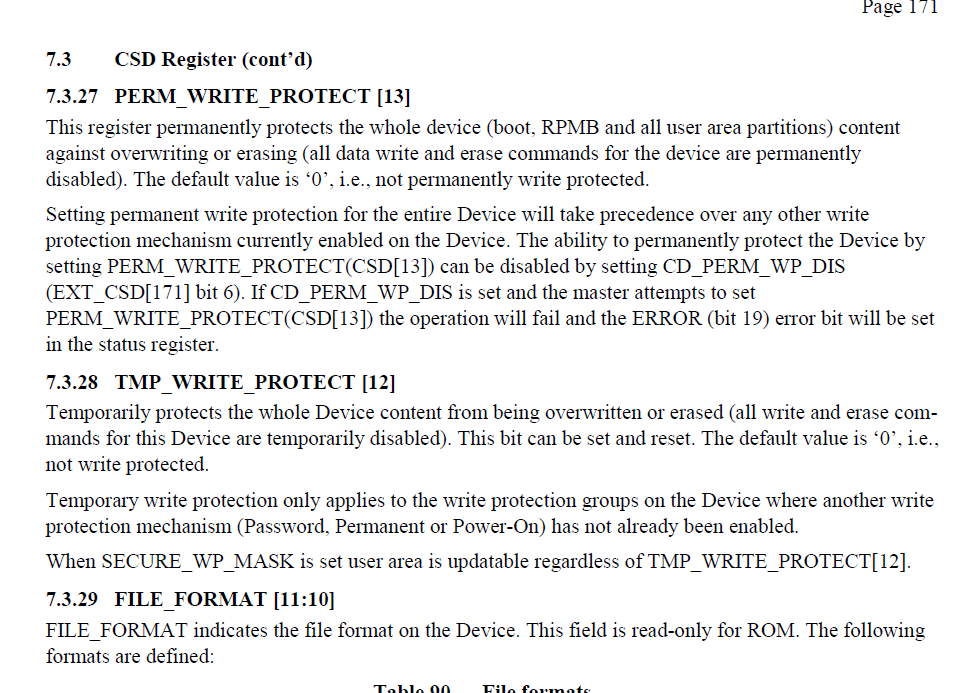

echo "CSD Register bit13 is PERM_WRITE_PROTECT ('..... 20 00' = issue happened)"

jackie2
Here is the test for user partition protection.
The fat size is 170391(186775 - 16384 ), the protection need to be multiple of 16384.

->Please make sure that PERM_WRITE_PROTECT is a bit, and can be used to permanently write and protect the card. When this bit is set, the card can no longer be written to. This can be useful for protecting sensitive data
Thanks for the clarification.
Yes, CSD registers (card-specific data) provide more information regarding access to the card contents.
one can set the field 13 to set permanent write protection and 12 for temporary write protection.
PERM_WRITE_PROTECT(CSD[13]) & TMP_WRITE_PROTECT(CSD[12])
->Please make sure that these registers allow the host to apply to write protection to the whole device including Boot Partition, RPMB Partition, and User Area.
->Further USER_WP (EXT_CSD[171]) register allows the host to apply to write protection to all the partitions in the user area. The host has the ability to check the write protection status of segments by using the SEND_WRITE_PROT_TYPE command (CMD31). When full card protection is enabled all the segments will be shown as having permanent protection.
->Please make sure to do boot partition write protection, BOOT_WP (EXT_CSD [173]) register allows the host to apply write protection to Boot Area Partitions.
->An attempt to set both the disable and enable bit for a given protection mode (permanent or power-on) in a single switch command will have no impact and a switch error occurs.
->Setting both B_PERM_WP_EN and B_PWR_WP_EN will result in the boot area being permanently protected.

jackie2
Sanket Parekh,
Under Linux, the boot partition default is ready only.
You need to issue the follow command to make the boot partition can write..
after write the bootloader flash.bin to the boot partition.
turn on the read only again.
question from stanAn is stanAn want to do write protection on emmc.
It already has under linux.
You can try without “echo 0 > /sys/block/mmcblk${mmc}boot0/force_ro”
You will see the boot partition can not write.
