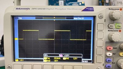

Currently I am working on IEEE 1588 PTP output verification, I observed that there's not a precise 1 pps when I enable pps. It should be 1pps Ideally in my perspective.  Would anyone help me figure this out?
Many thanks
Here are my steps as below:
step 1. Configured the function pin:
MX8MM_IOMUXC_GPIO1_IO09_ENET1_1588_EVENT0_OUT   0x01
step 2.  Revised fec_ptp.c
- val |= (FEC_HIGH_PULSE << FEC_T_TMODE_OFFSET);
+ //val |= (FEC_HIGH_PULSE << FEC_T_TMODE_OFFSET);
+ val |= (FEC_TMODE_TOGGLE << FEC_T_TMODE_OFFSET);
Step 3. replace kernel Image and dtb then reboot the system.
Step 4. enable pps
ptp4l -A -4 -H -m -i eth0 &
echo 1 > /sys/class/ptp/ptp0/pps_enable
Step 5. Use oscilloscope to check pps (Sorry I dont have the permission to upload image or attachments)
I observed the pps output waveform with Hi(2s) and Lo(2s) ( a.k.a the period is around 4s), I found there's a similar waveform in  i.MX IEEE1588 output test.pdf  page 6.
I'm using iMX8MM with linux kernel version 5.4.3, does anybody can help me figure this out please?
Thanks again.

Hi @Rita_Wang ,
Thanks for your reply!
Now I can get 1 pps output yet duty cycle is 50%, is it possible to adjust DC% of 1 pps output by any chance?
Currently I'm using Linux Kernel version 5.4.3.
Thanks again!
Ben

Ben_Teng
I can get 1 pps output now, and recently I'm trying to adjust duty cycle of each pulse.
e.g. Currently pps duty cycle = 50%, is it possible to adjust pulse width?
Ben

Ben_Teng
Here's the pps waveform, it is 4s per period approximately .
Could anybody guide me how to adjust the period to 1pps please?
pps_waveformpps_waveform
