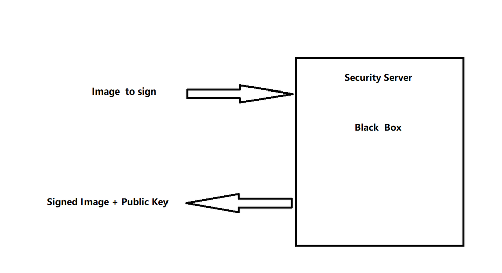

BiyongSUN
Surely, it could be done signing inside Yocto. Just make some bb files.
But it makes no sense.
Surely, a very basic   violation of security basic concept.
It should have a security server to sign for you. not you do it by yourself.
The security server is black box to you. You will never know the private key.
Your input is an Images and  security server output is a signed image and public key.
Of course, for i.MX could be csf bin, key hash.

petter-osterlund
There is no excuse to not provide automated build system with signing because of this.
1. The simple .bb files you talk about is quite difficult to write based on your documentation an support. This is the key issue on this thread.
2. The .bb files can send images to be signed to a black box for signing, wrap the signing tool.
3. The entire black box may even be the company official build server producing artifacts. R&D developers can then use a separate set of keys.This is the intended aim in our case.
