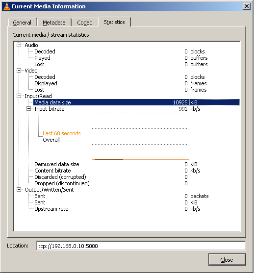

Hello All,
I'm trying to stream video from iMX6Q SABRE-SBP board to PC with gsteamer. I'm using Linux BSP 4.1.0 from Freescale Web with all necessary codecs installed. On PC side I have VLC player. I can successfully stream h.263 @ 1080p via 'tcpserversink' but I cannot do it for h.264 @ any resolution.
I'm aware about the bug discussed on the link below so locally I can get both h.263 and h.264 compressed files at 1080p.
gstreamer vpuenc H.264 encoder (codec=6) output not compressed
Similar problem has been discussed in the topic below but it ended up with streaming trough UDP (not clear successfuly or not).
H246 Network Streaming - iMX6 SabreLite - gstreamer
So far for me this works:
gst-launch mfw_v4lsrc device=/dev/video1 capture-mode=0 ! queue ! vpuenc codec=h263 bitrate=1000000 ! tcpserversink host=192.168.0.1 port=5000
This is not:
gst-launch mfw_v4lsrc device=/dev/video1 capture-mode=0 ! queue ! vpuenc codec=avc bitrate=1000000 ! tcpserversink host=192.168.0.1 port=5000
VLC captures h.264 stream but does not recognize it:
Output of gst-launch with debug:

'videotestsrc' shows the same behavior.
Did someone succeed to stream h.264 to PC?
