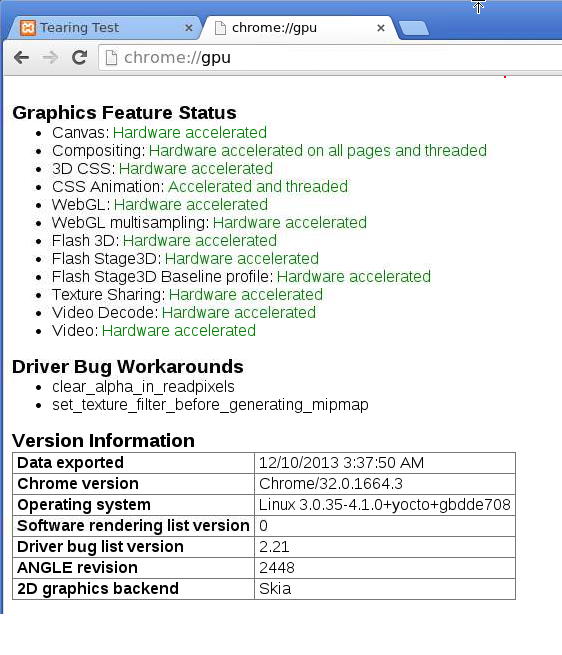

when using Linux/X11/Chrome on a SABRE Dual Lite  board, screen tearing artifacts are encountered within the broswer. Following setup is used:
- Yocto Release 1.5, including
- Linux imx6dlsabresd 3.0.35-4.1.0+yocto+gbdde708 ( only one cpu activated )
- X.Org X Server 1.14.0
- Chrome Version 32.0.1664.3 ( 227606 ), with all GPU acceleration options enabled
When the Video Tearing test - YouTube is displayed inside the browser,  tearing artifacts are visible. Tearing artifacts are also visible when swiping html5 pages.
If the same URL ( the YouTube tearing video )  is displayed on the SABRE Dual Lite board using an Android 4.2.2 image + Chrome 29.0.1547.59 no tearing artifacts are visible.
Is this behaviour known ? Are there any hints available, regarding the configuration of the subsystems preventing the tearing artifacts mentioned above ?
Any help would be highly appreciated.
Kind regards,
Gabriel.

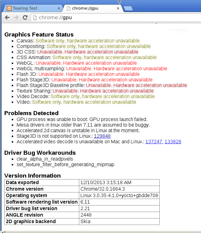

could you disable all the GPU in this application and use the software fallback to see if the issue still persists ?

gabrielliseanu
Hi Andre,
I've disable the GPU, but the tearing artifacts are still there.
Attached 2 screenshots showing the GPU flags used by Chromium. The first with GPU enabled, the second with GPU disabled. As already mentioned, no changes regarding the tearing artifacts between these two options.
Kind regards,
Gabriel.
