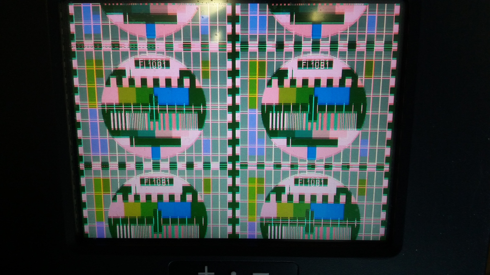

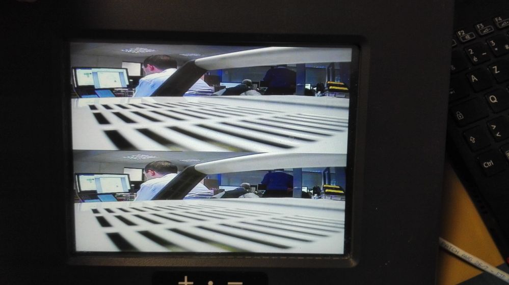

Good news,
The image is stable !!!!!
But we have 2 images.
So, now we have 2 stable images.
It seems to be odd and even frame.
The ADV7282-m is configured in order to be in progressif mode.
Why I display 2 frames?
How can I display the progressif frame?
Or How can I display only 1/2 frame?

qiang_li-mpu_se
Hi David, the suggestion for how to combine two fields into one frame had already been given to you.
With the above setting, if you can capture 2 camera videoes without scroll, they are correct two fields data, then you just need change the capture IDMAC ch1 to interlaced mode to combine the two fields data into one frame. In file drivers\media\platform\mxc\capture\Ipu_csi_enc.c, function csi_enc_setup():
 case IPU_CSI_CLK_MODE_GATED_CLK:
 case IPU_CSI_CLK_MODE_NONGATED_CLK:
 case IPU_CSI_CLK_MODE_CCIR656_PROGRESSIVE:
 case IPU_CSI_CLK_MODE_CCIR1120_PROGRESSIVE_DDR:
 case IPU_CSI_CLK_MODE_CCIR1120_PROGRESSIVE_SDR:
-  params.csi_mem.interlaced = false;
+  params.csi_mem.interlaced = true;
4,418 Views
dtamarii
Thank you very much,
With this last patch, I have 1 stable picture !! Thank you !!!!!
But we have a last little problem.
When "params.csi_mem.interlaced = false;" we always display 2 frames even when we configure the ADV7282-m on  progressive mode.
When we apply patch "params.csi_mem.interlaced = true;" We have one image but with comb effect (even when configured in progressive mode).
I think that I could resolve my prolem by displaying only one of the 2 images with "params.csi_mem.interlaced = false;"
How can I do that?
Have you an other solution in order to avoid comb effect (using internal progressive converter)?
David

dtamarii
We succes to displays only 1/2 frame.
It seems to be OK, no comb effect.
But we have to display only 288 lines instead of 576.
We have the same behaviour even when we configure the progressive mode for ADV7282-M.
I think that the good way to obtain 576 lines with no comb effect is to use the imx6 internal progressive converter.
How we can activate the progressive converter in order to display one frame with 576 lines without comb effect?
4,418 Views

qiang_li-mpu_se
With the "params.csi_mem.interlaced = false" code, it is for progressive input, just like MIPI CSI camera. It will save data into memory line by line.
And params.csi_mem.interlaced = true is used to capture interlaced input, when capturing data into memory, it will save data line skip one line.
4,418 Views
