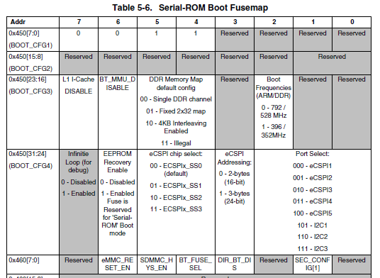

We are doing a iMX6 design, where we want to control boot device by setting the boot config through the GPIO pins.
We are booting only from a SPI NOR flash memory.
Looking at the fuse map (see figure below) there are signals/bits that are "reserved".
Does this mean that the state (high or low) of this pin at boot time is "don't care"??
I want to leave out the resistors pulling the "reserved" config bits either high or low, to keep BOM count low.
Martin Christiansen.

Untitled.pngThe boot pin is very clear in the datasheet.

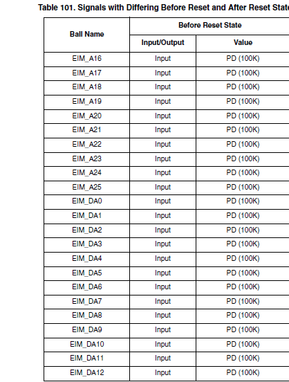

    You may use pulling up or down of the “reserved” boot pins, but please do not
leave them free.  For more details, please refer to
https://community.freescale.com/thread/358921
Yuri
