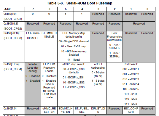

We are doing a iMX6 design, where we want to control boot device by setting the boot config through the GPIO pins.
We are booting only from a SPI NOR flash memory.
Looking at the fuse map (see figure below) there are signals/bits that are "reserved".
Does this mean that the state (high or low) of this pin at boot time is "don't care"??
I want to leave out the resistors pulling the "reserved" config bits either high or low, to keep BOM count low.

1.
  As for “How long is the window where the iMX6 "reads" these config pins??” :
The boot pins are latched at POR rising edge, but - strictly speaking -
the hold time  is not specified. Please look at sheet 13 of the i.MX6 SL EVK
design, where bus isolation buffer is applied and the next note is provided :
"i.MX6SL reads values approximately 300uS to 1mS after reset released.
Buffers are active while unit is in reset and 1ms-10ms after reset is released."
https://www.freescale.com/webapp/Download?colCode=iMX6SL_EVK_DESIGNFILES&appType=license&location=nu...
2.
> What are the "reserved" pins for??
As usually – for possible future options.
Yuri.

Yuri
    You may use pulling up or down of the “reserved” boot pins, but please do not
leave them free.  For more details, please refer to
https://community.freescale.com/thread/358921
Yuri

martinchristian
Hi Yuri,
I can see from the post you link too, that it is not completely clear why/how to tie those pins.
Martin.
